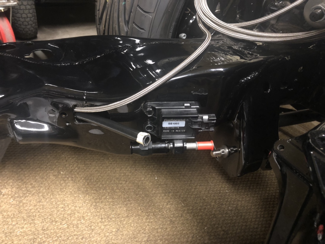

So just ordered the flex fuel sensor. Plan is to mount at old proportioning valve location.
Any ideas and photos on fuel filter location? Also should I run 2 filters or is 1 sufficient...

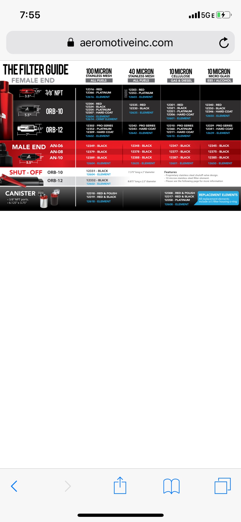

The ORB-12 is the biggest filter (in size) compatible with E85. Do you know if these is best over the ORB-10?
No reason to go that big
Orb only needs to be as big as the feed line being used.
I was going from -12 to -8... I like that the filter is longer. Not sure if that makes a difference in filtration lol.
More media area
So far this is what I’m thinking... Just need to figure out a bracket for the trans shifter.
