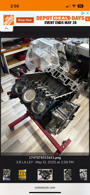

So just thinking on how much it will make with the following combo/ compression
4.1 stroker
girdled
ported champion irons
compression bumped up to 9.2:1
comp roller 212/218
freshly rebuilt 6266 DBB
TA performance 1.65 roller rockers
my guess it will make 600 at the tire pretty easy. The real question is... what will it make if i push the 6266 :oops:

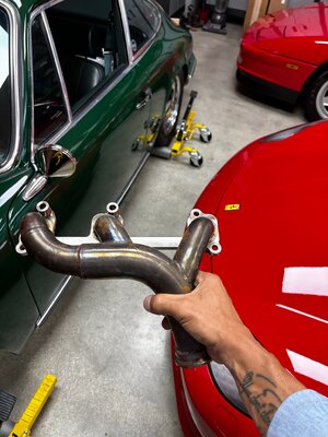

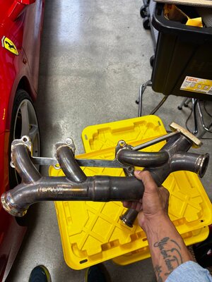

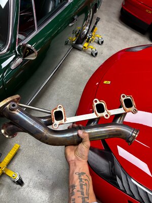

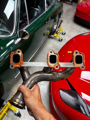

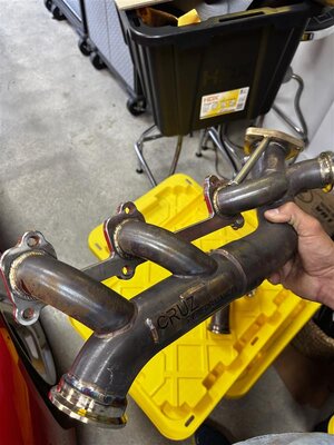

Add T/A race headers to your buy list. NOT street headers. Detail collector on drivers side and detail pass side welds and where tubes come into common tube. Sometimes the pass side tubes stick into the common tube as much as 3/8". Other than that they are beautiful!
I made a heat deflector above the drivers side flanges and added insulation above it to keep from frying the wiring harness.
TIMINATOR
TIMINATOR
I already got Cruz Performance Headers with a 3.5" cruz downpipe as well.
