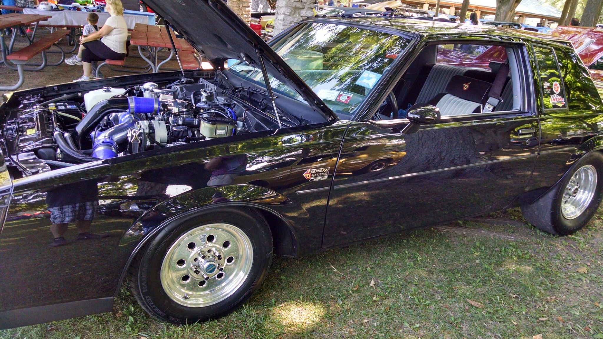

Mine are 275/60-15. Wheels are 15x8 4 1/2" backspace. They fit and look great.
I will be happy if the Pro's do any better with no changes to the car. Piedmont track prep was excellent last year despite the weather.
if the prep is there and the car can make enough power the pro will go faster.
I have the exact same wheels and they just barely touch the frame rails, had to do a 1/2" spacer but 1/4" might have worked.
