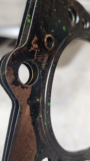

Hey guys, Took my heads off due to oil leakage between the layers of copper on the gaskets and noticed all of them had this issue. please look at pic, the copper seperated at several locations near every bore. I have champion heads, arp studs, torqued to 75 ft lbs. The gaskets are for the proper bore size and a sprayed a copper coating before installing. I am running E85.. Any suggestions will be appreciated...

Yes, Ive encountered that issue. I smeared high temp RTV between the layers at the oil hole areas. Been like that since 2016. No leaks since.
Ralph, post a better pic of the torn area.
It looks like the inner part has not been clamped down to the block.
Did you check the fit on the heads and the block?

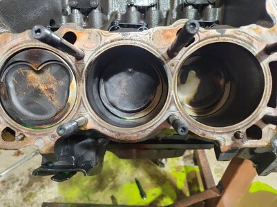

GM Chuck, Dowel pins are in block. I took the angle pic so you can zoom in and see the broken seam , if I take a pic from top you see nothing due how small the cut is. Also, I have 5 dyno pulls and about 500 miles on this E85 setup, I am surprised how much carbon is on the piston tops and how different they look from one another.

Are all the cracks at the same side of the gaskets?
Are the cracks at the top or bottom?
You're talking about the fire ring separating from the rest of the gasket?
IMHO, it looks like a fail do to detonation unequal fuel distribution.
I have talked to several shops about copperkote and RTV silicone used with Cometic gaskets. Some vendors/ shops remove the rivets and put a light coating of silicone around the water and oil holes between the gasket layers. Some spray a light film of Copperkote on both outer surfaces of the gaskets before installation, some let it dry, some install them wet.
According to my several conversations with both the sales and engineering staff at Cometic:
Copperkote acts as a lubricant and allows the gasket to move and squirm as cylinder pressures rise. Silicone between the layers or between the gasket and head and deck surfaces, causes uneven clamp loading around the combustion chambers. Both issues will lead to failure.

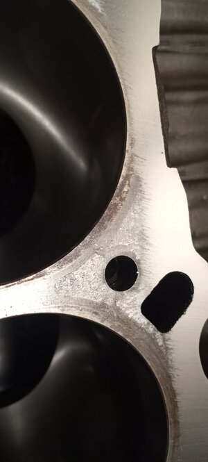

Pic of my block previously milled (not BHJ ed) on an "old timey" broach, and after one pass at .001"cut on my CBN milling machine. You can easily see the irregularities of the broach cuts, and also how far off the decks were from correct "blueprint" orientation.
Follow the manufacturers instructions, look at the pic, and draw your own conclusions.....
