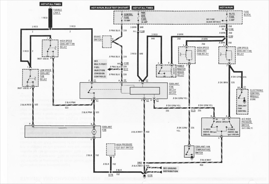

Sounds like you have something going on... Since we jump out the hi/lo resistor the chip turns it on before hi-temp/hi-speed switch gets on the clock..
What chip do you have? Sounds like it's time to test the low speed relay circuit.
www.vortexbuicks-etc.com/fancircuitA.jpg
