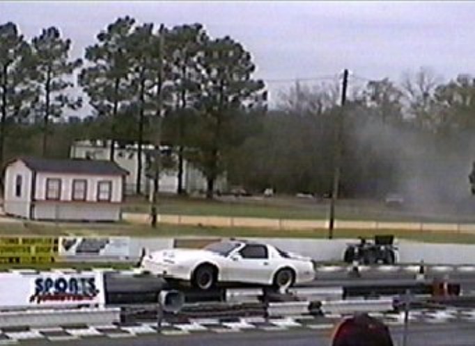

had my tta to the track for the first time this summer results only got two runs first
60ft 2.00
330 ft 5.16
1/8 77.76
1/8 mph 94.93
1000 10.02
1/4 11.90
mph 121.30
second run i will not post too imbarassed
this was on pump gas/alky stock engine car and no tune.my car just dose not seem to lleve the line hard,my car will not build boost on the line.i have a 3200 stall and te61 turbo any suggestions on how i could build boost.
