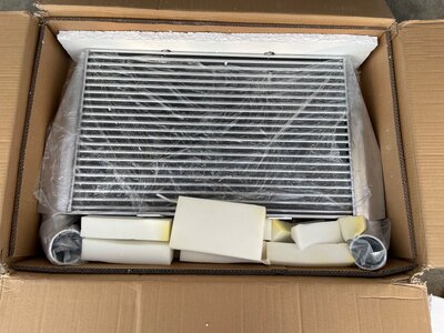

RJC Racing has a new amazing front mount. I have not been able to test it yet but it looks amazing for a street car. The airflow looks crazy good and it's weight is only like 13lb. It should work well with a street car with air and perform at the strip. Good for high 9's I think.
Small jpg of RJC new street front mount. This is the new street version front mount. Its full size of the radiator.

It comes with another box full of all the FM pipes hoses and clamps. :)
And yet you think adding a huge intercooler in FRONT of the ENTIRE radiator and CONDENSER won't affect engine cooling and A/C......

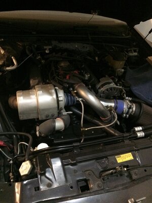

I'll take more photos of it out of the car. It's on my shelf but it IS a V4R!!!! I had them raise it higher so it's not so low on the street. I've owned the V4 in my GN and this is WAY bigger than that!! And RJC model number just changed!! He changed the core!
The hoses, piping, and size is SUPER different than a V4 for the V4R!!! WAY bigger!! The V4R has the intake pipe UPSIDE DOWN!!! And has custom hose bends to fit!! IT IS THE REAL DEAL!!!! I'll take a snap of it out of the car when I have time. IT IS A V4R!!
