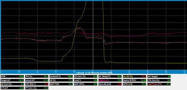

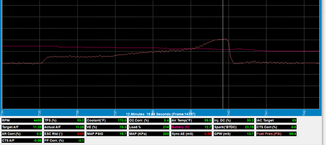

screen shot 77 is where the inj duty cycle alarm came on from a few days ago 76 is from yesterday

Your voltage is low, especially at that RPM. It almost looks like you're running on battery alone since with an alternator running, your voltage should be in the mid 13s or higher. FP looks to be dropping off as voltage decreases too. Not necessarily correlation = causation but that's what immediately stands out to me. I'd start by having a look at your alternator and the rest of the electrical system.
