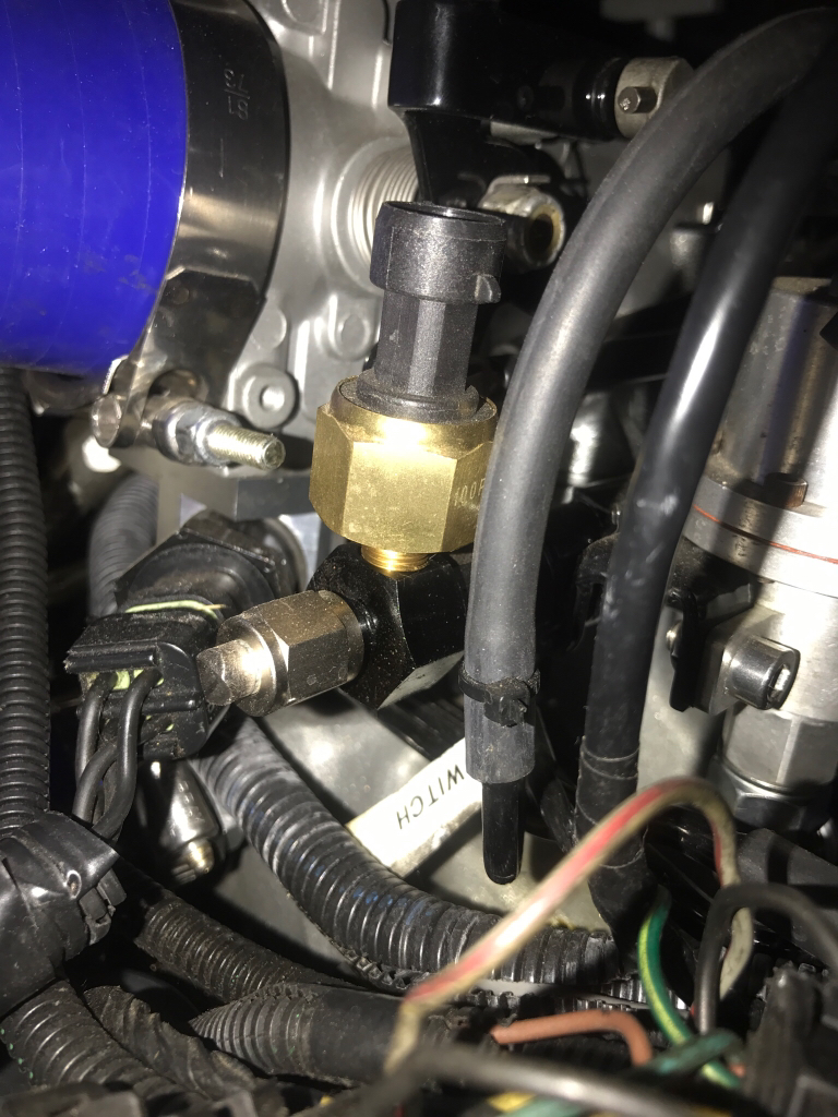

Got a autometer for mines forget the part #, it doesn't plug straight into the fuel rail it goes on an adapter. You will have to do some fab work or find someone selling something if you plan on still using an underhood gauge also.
I bought an eBay sensor that screws right on the rail
I have a autometer on the rail that I have running my FP gauge and I also tapped into it to record .u just need a 0-100 transducer with a 0-5vdc
Looks like the one on my car except for the color of the body:
You have to go into the notepad for the PL and add the specs for a custom input on channel 4 or 5 . It should be something like this 0.5vdc=0psi and 4.5vdc=100psi I actually have a transformer if u need one . It steps 12vdc down to 5vdc .
That should work fine but personally I would go with something of known quality when dealing with my gauge readings.
