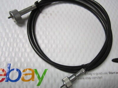

the highwaystars cable is slip on for OE speedometers not for SW/vdo mechanical speedos
search ebay they are listed as VDO speedometer cable , 38" will work if using the factory lower cable
napa may also have something like it
The link above is what I would go with. Just remember on a GNX there is a hole drilled through the A/C duct for the cable to have a straight shot to the back of the speedometer witch you will have to make. Do a search for GNX dash install and you will see what I'm talking about, it uses a piece of white pvc plumbing pipe to make connection under a bathroom sink is all that was used to fill the hole drilled for the cable and have the duct still work witch can be had at home depot or any hardware store.
When I put in a mechanical speedometer I needed to drill a hole in the vent duct behind the instrument panel and epoxy a small piece of PVC pipe in the hole to run the cable through. It was for an AVC Panel. I'll see if I can find the instructions and post.
I may have the right cable for the Speedo. It’s a screw on style
Here you go, also gn restoration carries it.i have the plans to install somewhere ill look and post.
