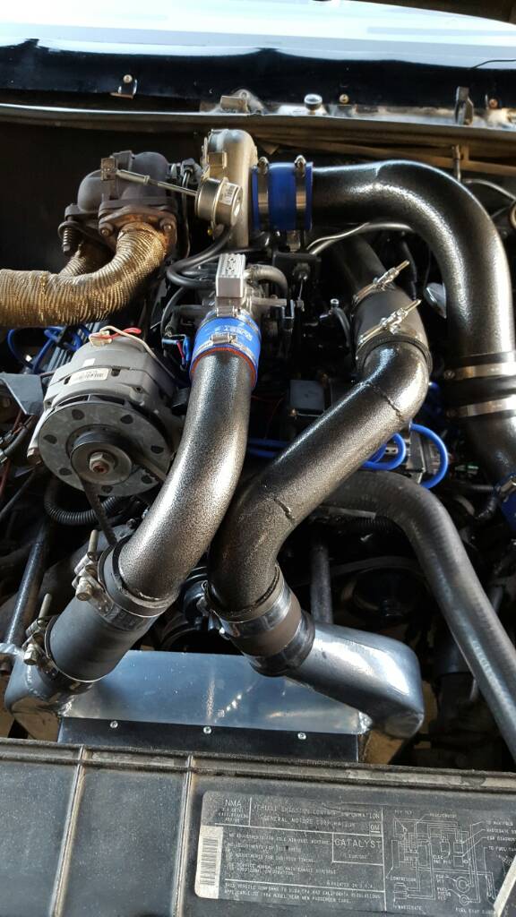

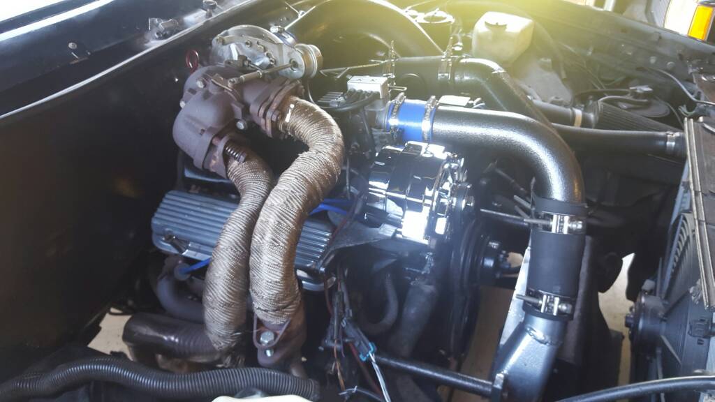

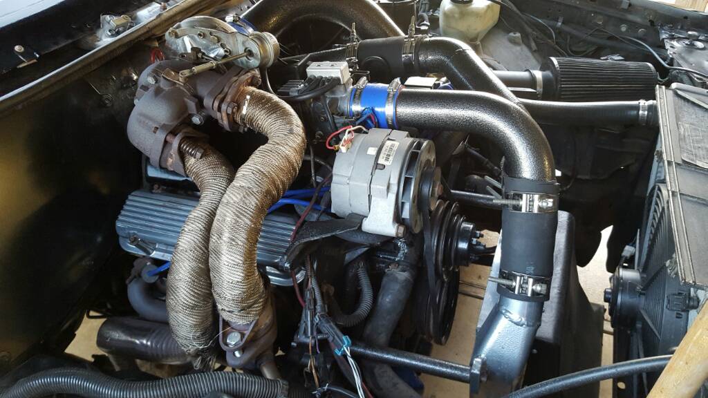

Going intercooled
I think you can now drive the car. Enjoy and get some SEAT TIME....Post some times
I did mine not to long ago, and runs like a bat of hell! 10 lbs of boost, and she flys, on a te-60 turbo 50 lbs inj, 87 intake, 87 fuel rail, 2800 stall, power logger, port and Polish head, your gonna love the sound, and tt chip!
Sy1322, how are you enjoying the car? Night and Day difference.... Get more seat and take it to the track...
Just wanted to add, it's been a while since I posted and did the conversation from hot air to intercooled, it's the best thing I have done, the throttle response, and the power is like night and day, just wanted to thank the guys for helping me through the process it's well worth it!!!!!
Sent from my SAMSUNG-SM-G890A using Tapatalk
Maybe 6 to go may chime in... I use all 86/87 parts when I did mine.
Either the HA IAC or the IC 86/87 IAC will work IF you use the same year housing. There is just enough dimensional difference
to cause it not to work if you mix up the IAC housing. The actual valve will actually assemble into either housing it just won't
work right. This change is the single biggest improvement I have ever made. You can make it even better by straightening
out that bend in the pipe that goes from the turbo down to the IC. A cutting wheel and a chunk of AL pipe and some TIG
welding works wonders here!
