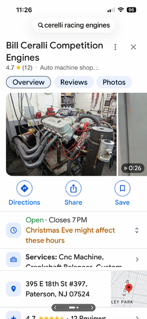

Where are you located I just told you a place that does it and will provide you with a flow sheet.They are in Patterson N.J. I am sure you can ship the heads to him.His name is Bill Cerelli.

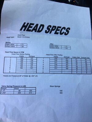

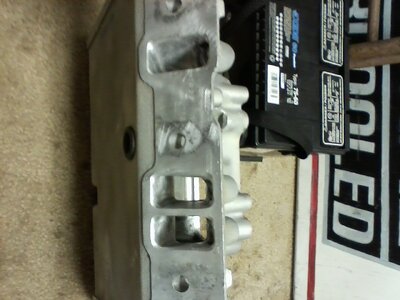

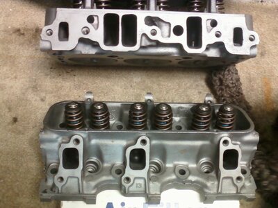

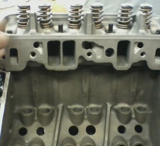

Ok bit far but I guess you could ship.He has done 2 motors for me and 100’s for my builder, very familiar with everything TurboBuick.My heads flow better than champion irons that he did and port matched the intake.

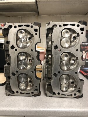

Here’s mine that he did a few years ago
