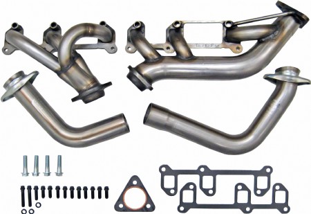

SignUp Now!My opinion only, TA stock replacements are sufficient for your stated purposes and should not affect spool so long as the rest of your combo is sound. Which is kind of what Pronto and others have been bringing to light since page 1. I have no practical experience with TA race headers so I will defer to those who do. In the end it’s your car and your money so consider all the information given and just go with what you feel is best for you. If it doesn’t work out, so what? There are worst things in life and the only person affected is you.T/A HEADERS, or REPLACEMENTS for my street car? Do the T/A replacements (which look like they flow better than the stock stuff) Crack? Are the replacements sufficient for my combo? Or do I need actual headers, or will headers slow the spool?

My car is a HP street car, with ported stock irons, ported intake, 70 mm T body, upper, plate, 62/62, RJC slic, 3" dp, dual 3" exhaust, alky inj., Eric chip,, 340 pump, billet regulator, gauges, modded rear suspension, built trans, 2500 lock up, bolt in 9" with 11"x 2 1/4" brakes, and H.P. Street tires.

I've pumped 50+ lbs of boost through the ta race headers repeatedly.My opinion only, TA stock replacements are sufficient for your stated purposes and should not affect spool so long as the rest of your combo is sound. Which is kind of what Pronto and others have been bringing to light since page 1. I have no practical experience with TA race headers so I will defer to those who do. In the end it’s your car and your money so consider all the information given and just go with what you feel is best for you. If it doesn’t work out, so what? There are worst things in life and the only person affected is you.
I don’t think any header is immune to cracking on these cars honestly, including the TA’s. But the TA’s will resist cracking much better than the stock stuff by virtue of the better, thicker, materials used. Again, I’m just giving my opinion only based on my limited experience. Others may have had different results, good for them.
Good luck with whatever you decide and keep us posted on your progress
To sum it up, do the replacements, ive never seen them crack yet, the replacements ARE actual headers, the stock headers were a fantastic design just the metal was a poorer quality.T/A HEADERS, or REPLACEMENTS for my street car? Do the T/A replacements (which look like they flow better than the stock stuff) Crack? Are the replacements sufficient for my combo? Or do I need actual headers, or will headers slow the spool?

 LOLBison is a good dude, get it together, get it sorted, log all your tuning runs, then see what you want. He won't sell you something that is not an improvement or a benefit.Talked to Bison yesterday, and the consensus is he seems to agree with my combo, but until I actually have enough data of what it is doing, he would rather wait for solid data before making a final converter recomendation. The A/C convertor is an unknown, and at this point how the car reacts to it all is too. I will talk to T/A Monday, and order something, replacement or race as Mike deems fit. Then I will continue assembling my engine and get hard data.
I also realize that I can't directly relate blown bbc at 9 sec, turboed 2.3 pinto 4 speed (my street car) at 11s back in 1982, a ton of 5 speed Hondas I have done for customers, and what I'm building now, I am with help from all of you, trying to come up with a realistic starting point. Once together, we can get it closer to where it needs to be.

Being the anal (short for analyze) guy that I am, I am going to flowtest the race headers, and then C.C. them for volume too.After buying the race headers, now I see that the primary tubes are all 4 to 6 inches longer which should be good for more torque and stall speed, they have a more efficient angle into the collector pipes for better flow and HP, the v band connectors that I did know about, a double slip in the crossover that doesn't require clamps to seal, that I didn't know about, thicker head and turbo flanges, and they are made of 304 stainless, which is stronger, less Crack prone, and more expensive, than the 416 series of the street replacements, I would never even thought about getting the cheaper ones!!!!!

Possibly the added area of the longer primary tubes might possibly slow the spool slightly, but the added torque and HP down track, should waaaay offset slightly slower spool. I will calculate the added volume of the longer primaries and post it, but I think that it will only be about 9% or so.
I would rather have a few hundredths slower spool, and the rest of the gains on the street, or the length of the quarter!

Can't wait for these results! Congratz on the purchase. I am also looking to get a set of race headers in the near future.Being the anal (short for analyze) guy that I am, I am going to flowtest the race headers, and then C.C. them for volume too.
I will also borrow a set of street replacements from T/A if Mike is up to it, or if someone wants to bring over a set that they have laying around, I'll do those for comparison. Volume and flowtest will give us insight into H.P, and spool up capabilities, and characteristics. I had to sell my engine and chassis dynos when we were annexed into Avondale,AZ. Damn commies!
I would love to see back to back engine and chassis dyno comparisons, along with dragstrip runs too.
I am currently thinking that the more efficiency and better flow of the race headers, may actually result in a quicker spool even with the slightly higher primary volume.
