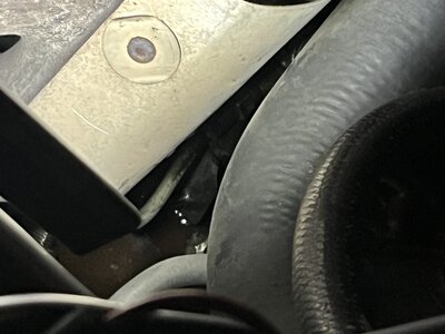

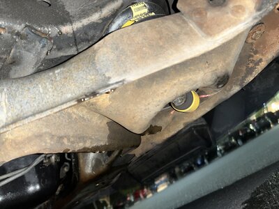

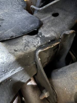

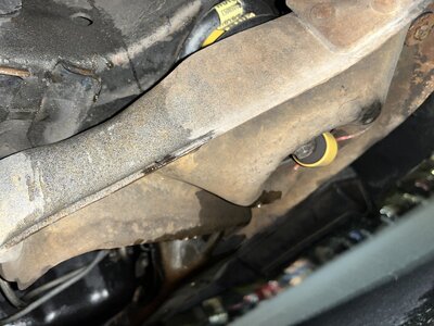

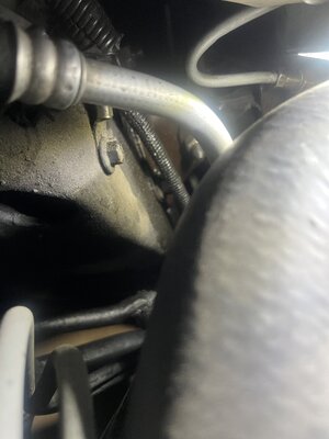

Hello,
I have 2 different leaks on my 87 but can’t pinpoint the exact cause.
First leak is on the passengers side behind the wheel. It’s a clear leak like water coming from the top.
Second leak is behind or nearby the turbo feed line.
Thank You.

Hope your passenger wheel leak isn't a brake line. Check brake reservoir, then you might need to pull the wheel and have someone hit the brake while you check the line as complete as you can see.
Turbo feed line starts at brass block on the engine, then runs up to the turbo so this one you'll want to clean the block and turbo oil inlet and run the car and check closely. Might just need a 1/4 turn tightening etc from rattling for many years untouched.
