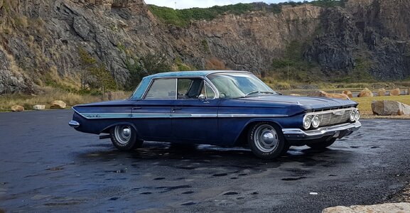

Thought I'd better introduce myself after gleaning info from here for quite a while. I don't own a Buick and they aren't common over here. I do have a bit of a thing for '56 2 doors though. And the g bodies of course. That brings me to the reason I've searched the forums and joined. I have a 200-4R to build for my '61 Impala with 350 to replace the powerglide. I'm really only acquiring bits and pieces at the moment so when I'm able (back injury) I'm good to go. I've got all but quality rebuild kit and billet forward drum to go. These boxes are very uncommon down under but I really thought it worth importing one over using the 700r4 that is available here. The info from these pages is priceless.

Welcome to the forum. That’s a nice looking car you’ve got there!
It looks like you need a quality rebuild kit and a billet forward drum. Do you need a rebuildable 200R4 as well?

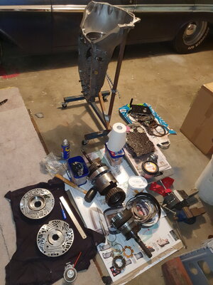

Thanks mate. From what I've read Dave is the man. I already have a good core and I'm collecting bits when I can afford it. I've got most the hard parts sorted except the forward drum . I'll talk to Dave about that and a soft parts kit. It's a bit of a long term project though as I'm waiting for a fusion of my back.

I've had the box in my garage for 2 years. It's pulled down. So far I've got sprags, 10 vane pump, sun shell, stator, teflon pump bushing, and probably a few other bits. I'm also waiting for rear selective washers and I've gone with a transgo hd2 with servo. By the time I had a CK kit and servo I would have spent at least twice what the transgo kit is. Better spending money on a kit and billet forward drum. Also need a billet anchor etc.
I'll get in touch with Dave Husek for the other bits. He did say on FB to call so I'll get in touch to see what he can do for me. As it sits it probably about 400 hp and same torque. But I have thoughts of adding a torqstorm sometime.
