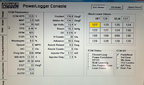

Having the High BLM issue (stuck at 150) and it has recently started happening. Have had the car about 15 years and haven't had to deal with it before. Its a california car so i have had to have it smogged every 2 years and not had any issues. Car had been running great up to this point. I've gone over the basic stuff. I've attached an image of the power logger console after starting it up. Seems to be stuck in Cell 0 only. Looked for vacuum leaks and couldn't find anything. Tried to take it to a mechanic and all they could find was the Ignition Control Module needed to be replaced which they did with an AC Delco one. That still did not solve the issue. I'm left with trying to figure this one out myself. Any ideas or things to try? Thought it might be the stock MAF and tried replacing with a blue streak one but does the same thing. Reading below is with the bluestreak MAF. i'm currently running the stock chip. My turbo tweak chip was also doing the same thing so i haven't swapped it back.

water temp is 127 and ECM is calling for 12.8
get it wormed up and drive it and not just around the block the send a screen shot
Do you have a 6.1 TT chip ?
If so remove the orange wire at the battery , reinstalled the chip and double check the WB setting

IAC at 51 he has 16 in vacuum at idle 800 RM, I don't think he has a vacuum leak. Unplug the orange wire reinstall the 5.7.
Ill be honest don't know what the OE 02 should look like ,But it looks like a lean number to me. If it is it would be a good reason for the ECU to add fuel. And time for a new Denso.

New data in for him. I have a screen shot of my car sitting in the staging lane.its a little wormer water temp ,I was hot lapping but it made a other 11.5 pass. your PL should look like this at water temp 160+

Your 02 v are off (you need a 02 sensor)
