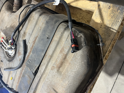

Yes I have taken my car to what I think is its SAFE limit
What is in the sig will be taken to the next steep. I started at Fullthrottle for bigger injectors that lead to bigger fuel pump and lines.with room to grow into a E85.

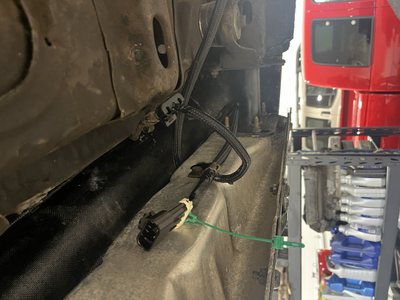

I have. a new pump and hanger from Racetronix ship from Fullthrottle and my old Hot wire no longe will work.

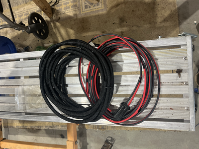

My Holley harness from Caspers has a designated 30amp circuit, so I called Justin and he sent me 25ft of #10 red and black wire with shield with a plug installed.If you have a holly from Casper this is a must have. It came just like the I/O plug with lots of wire so I would have enough wire to do it my way.
