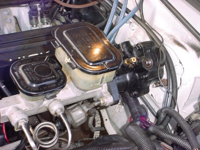

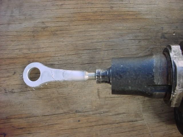

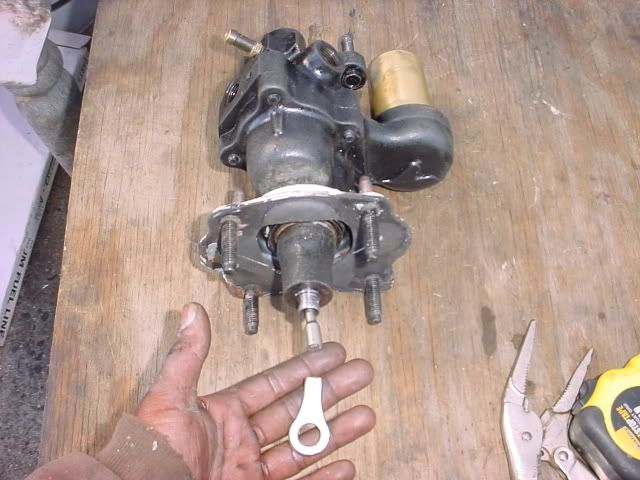

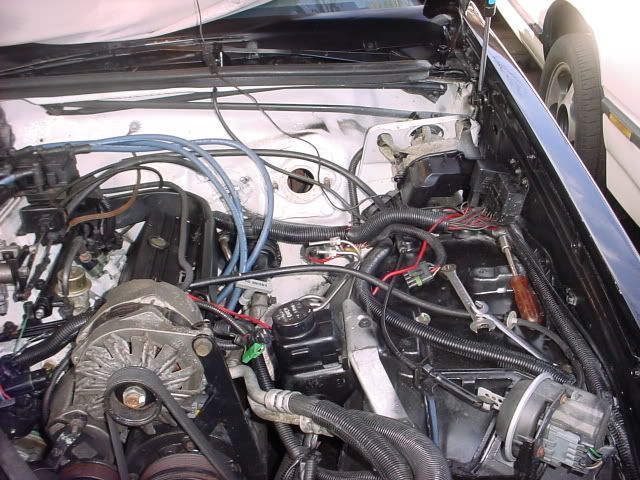

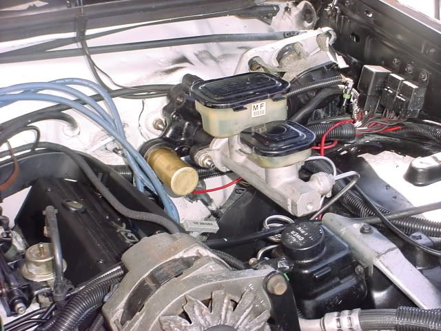

I was able to remove a HB from a 95 chevy astro Van 4X4. U will need to shorten the padle shaft 1 inch. i pic in yahoo photo. LOVE the C5 brake with the HB. currently installing C5 rear disc brake.
