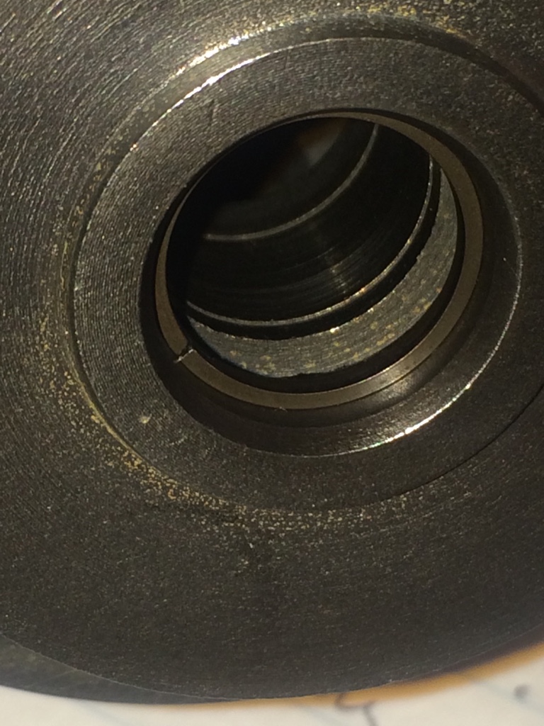

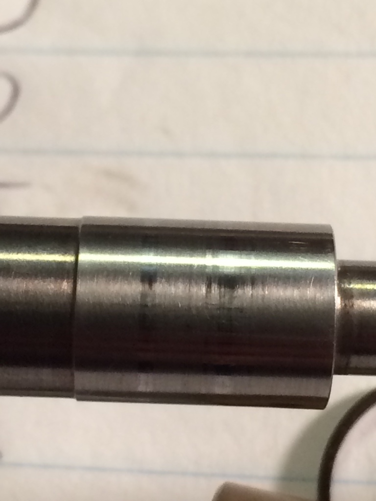

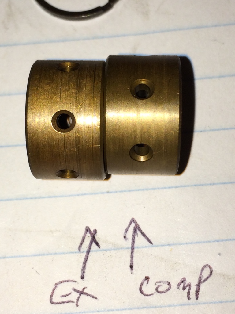

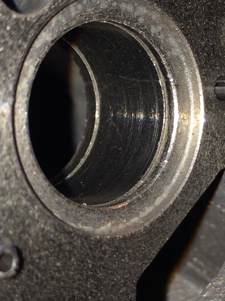

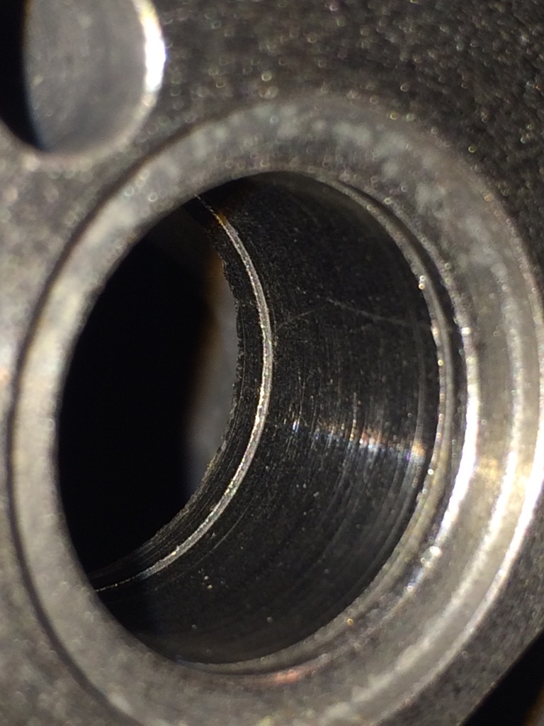

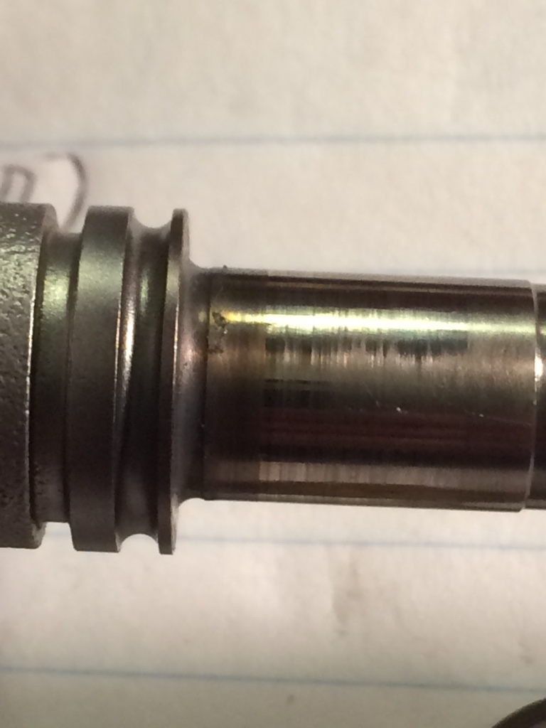

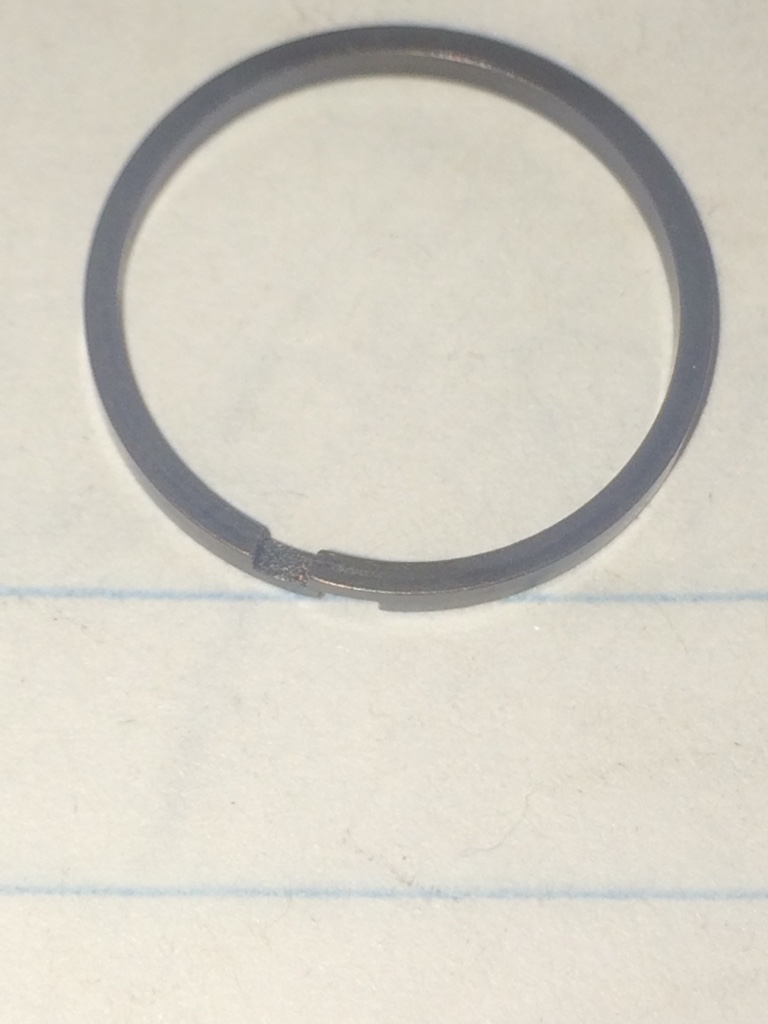

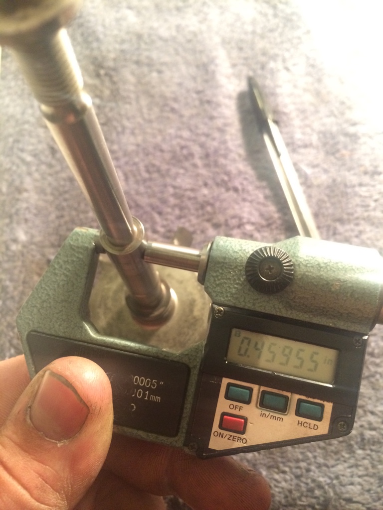

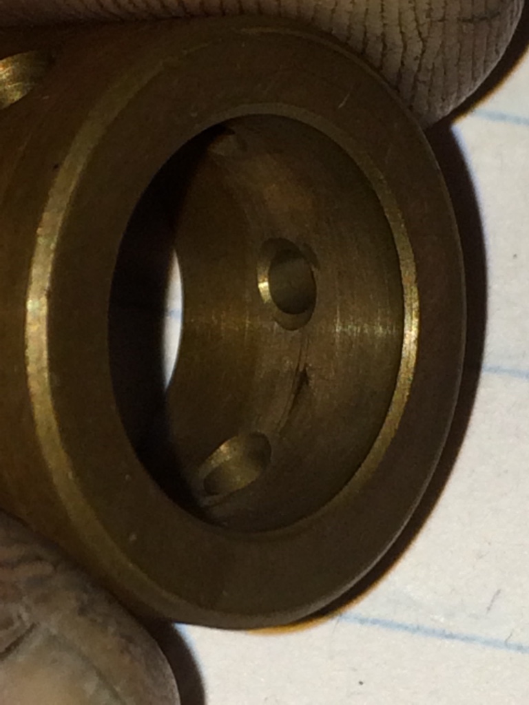

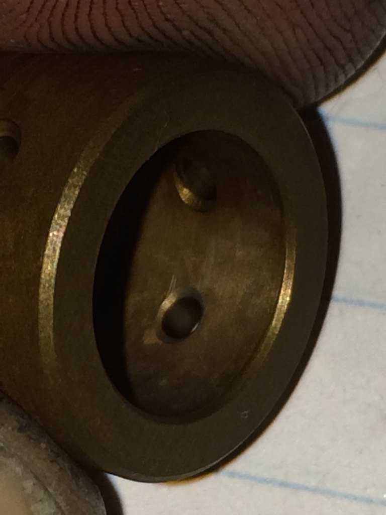

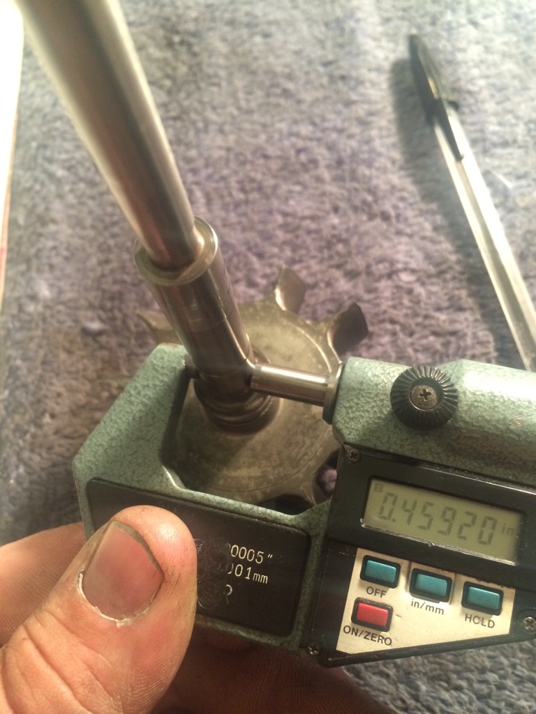

+.00030"/-.00000 tolerance on bore dimensions. I used a telescoping gauge for bore measurements. Not 100% accurate. The shaft dimensions are within .0001".

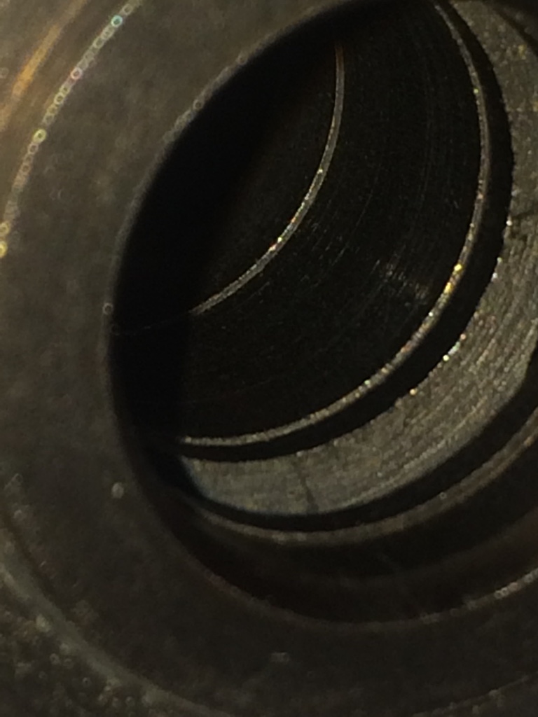

Ex side sealing ring bore .7905
Ex side jb bore .6833"
Comp side jb bore .6834"

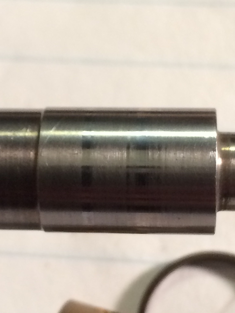

Shaft journal ex side .45920"
Shaft journal comp side .45955"
Sealing ring bore is perfect and ring has excellent tension.
The ex side journal is .00055" under the min and the comp side is .00015" under the min. To get the most oil control the ex side journal should be .45970"-.46000"

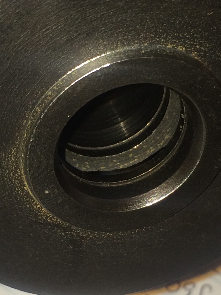

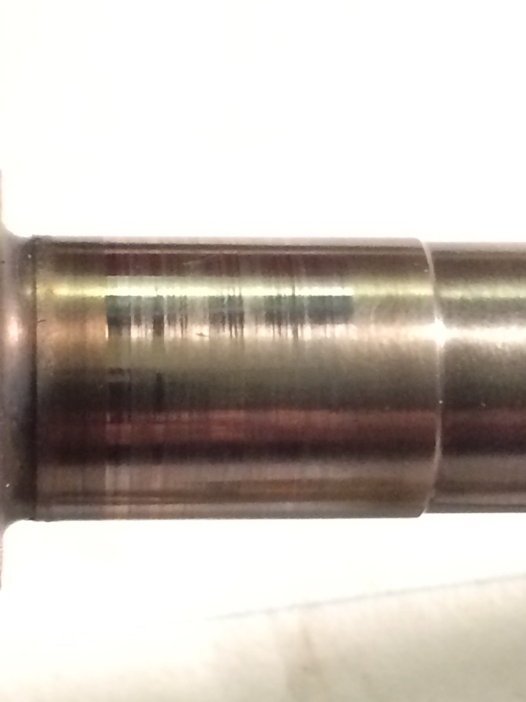

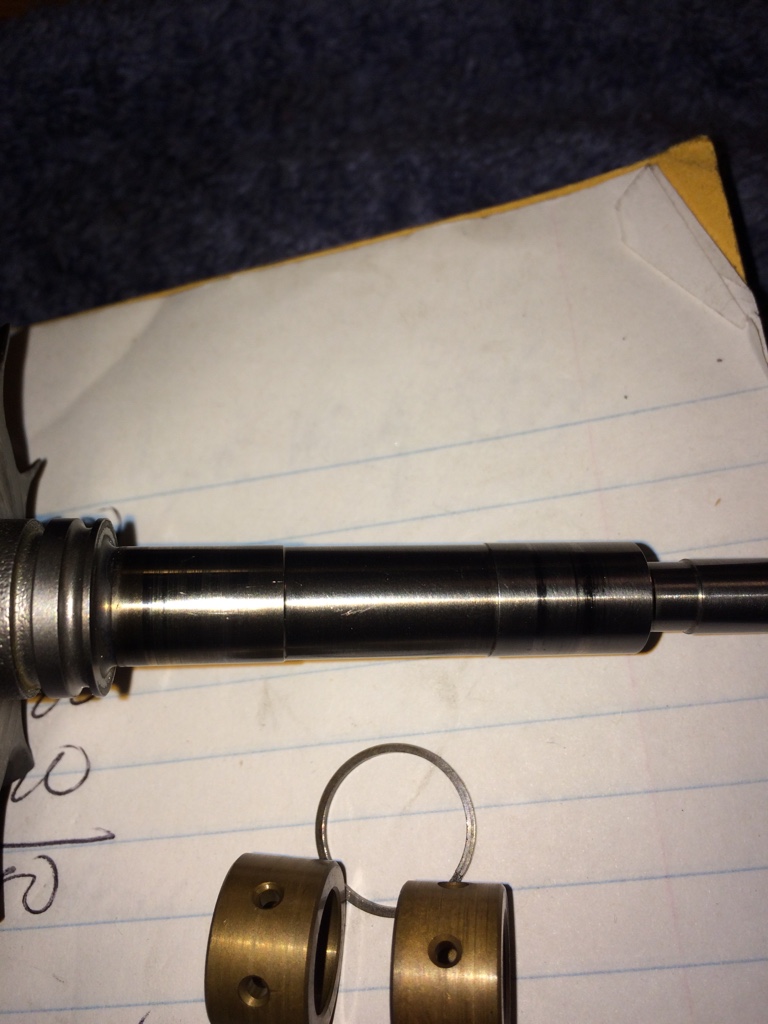

There is some light evidence of debris. The parallel lines are scoring from foreign material entering the cartridge.
Additionally a 270* thrust could be used to reduce oil flow through the cartridge.
