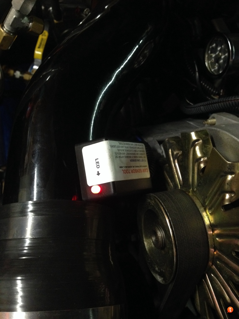

So here's an update. Wanted to check the NOID light again. Getting a fade illumination on all six injector plugs and can smell gas (I may have made an error maybe). So at this point seems like the ECM is next.

ok, so we are getting some fuel.
have you double checked the cam sensor timing.
what chip are you running?. perhaps unplug the MAF and see if it will start.

I'll check the cam sensor.

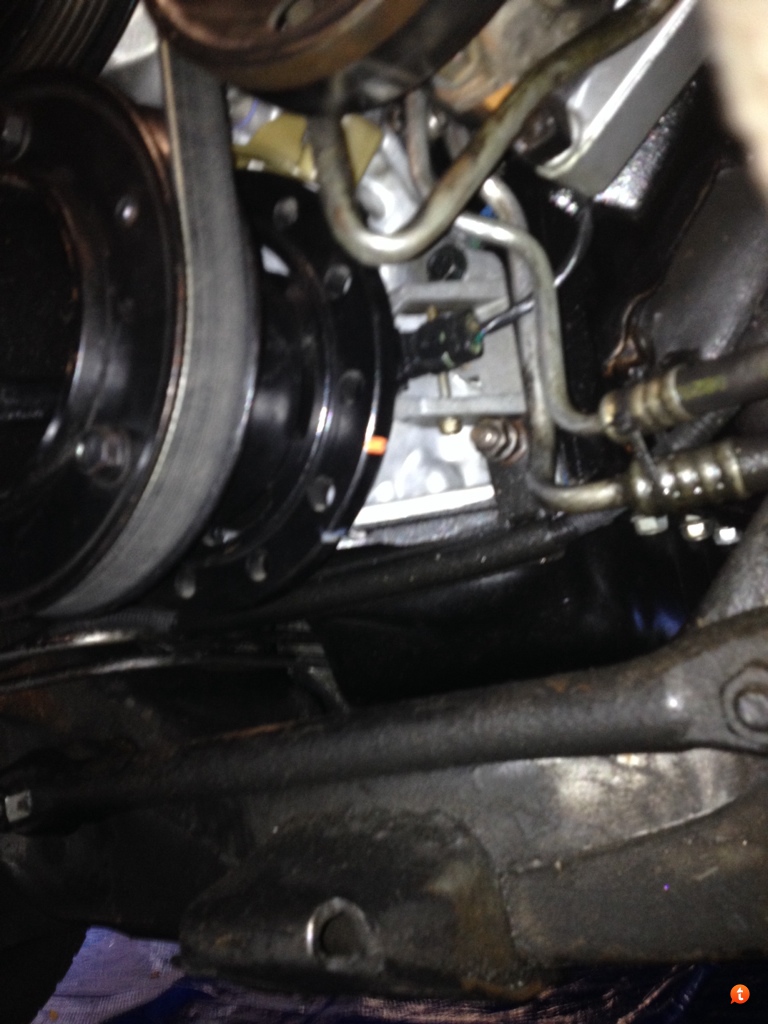

So I think I found the issue. Can anyone see what I am seeing?
Walter
Cam sensor off, or timing chain jumped a lot. Looks pretty clean in there. How new is the emgine
