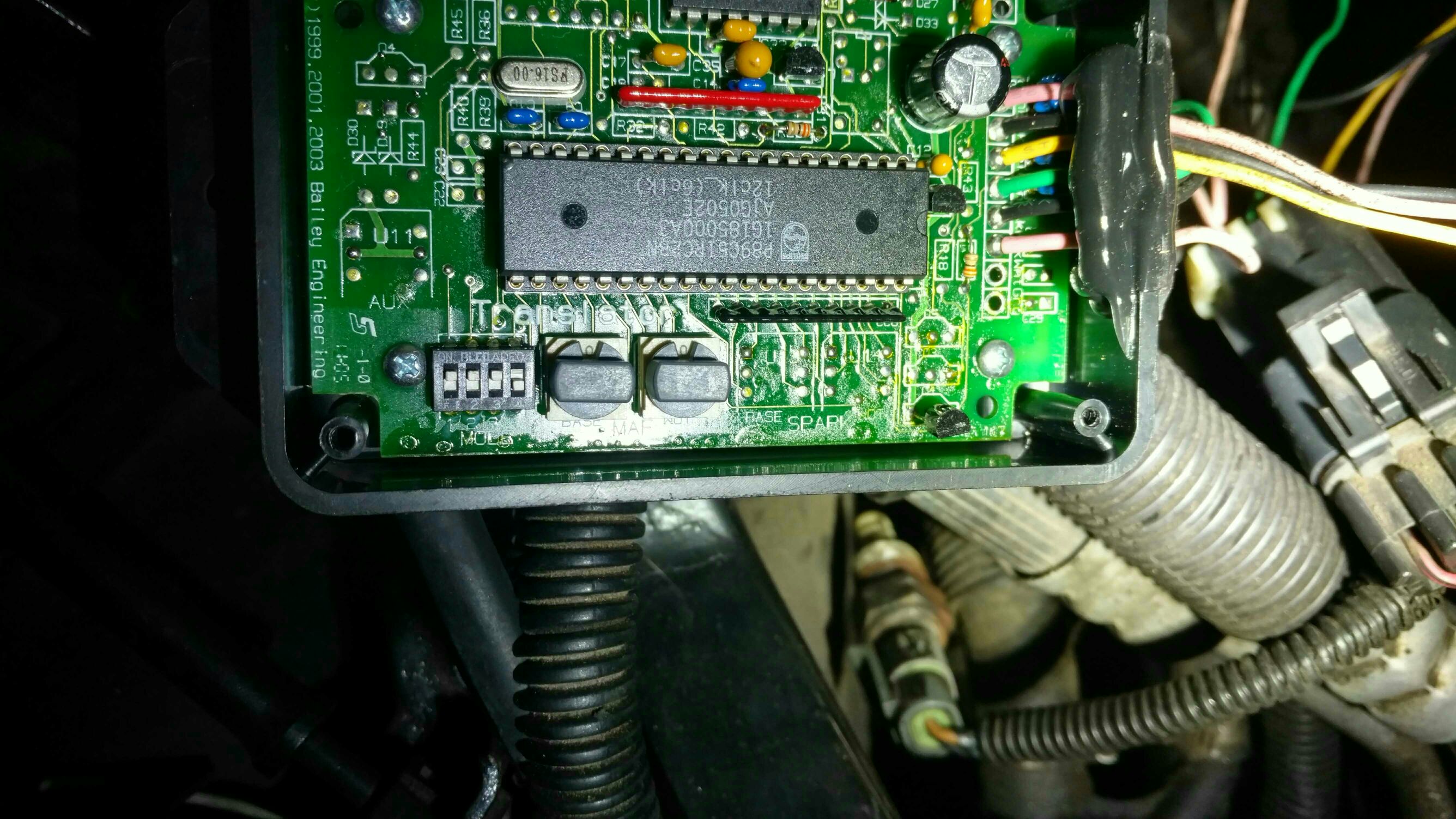

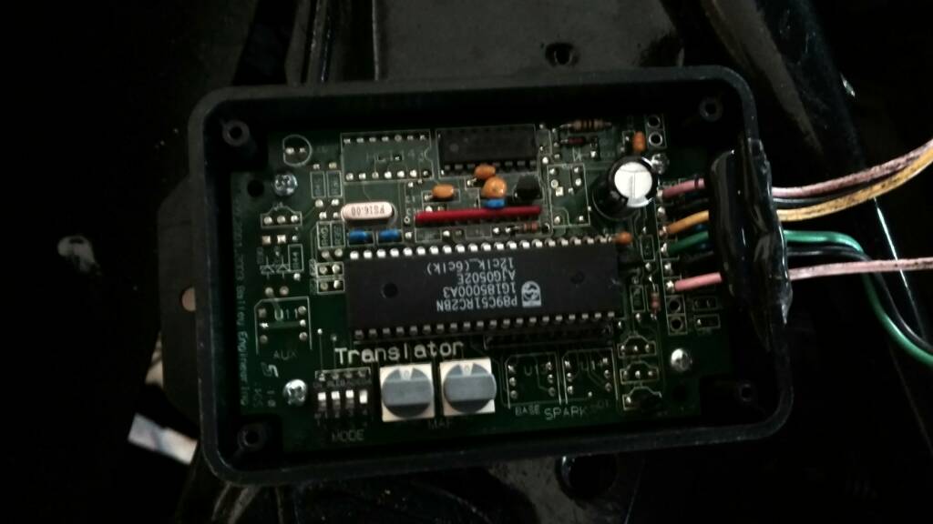

I installed a new ls1 MAF and a translator and now the engine runs worse than before it stumbles and hesitates if you rev it up here are my settings

You should zoom in on switch settings so the pros can see them. Alot of people seem to get the switches wrong at first.

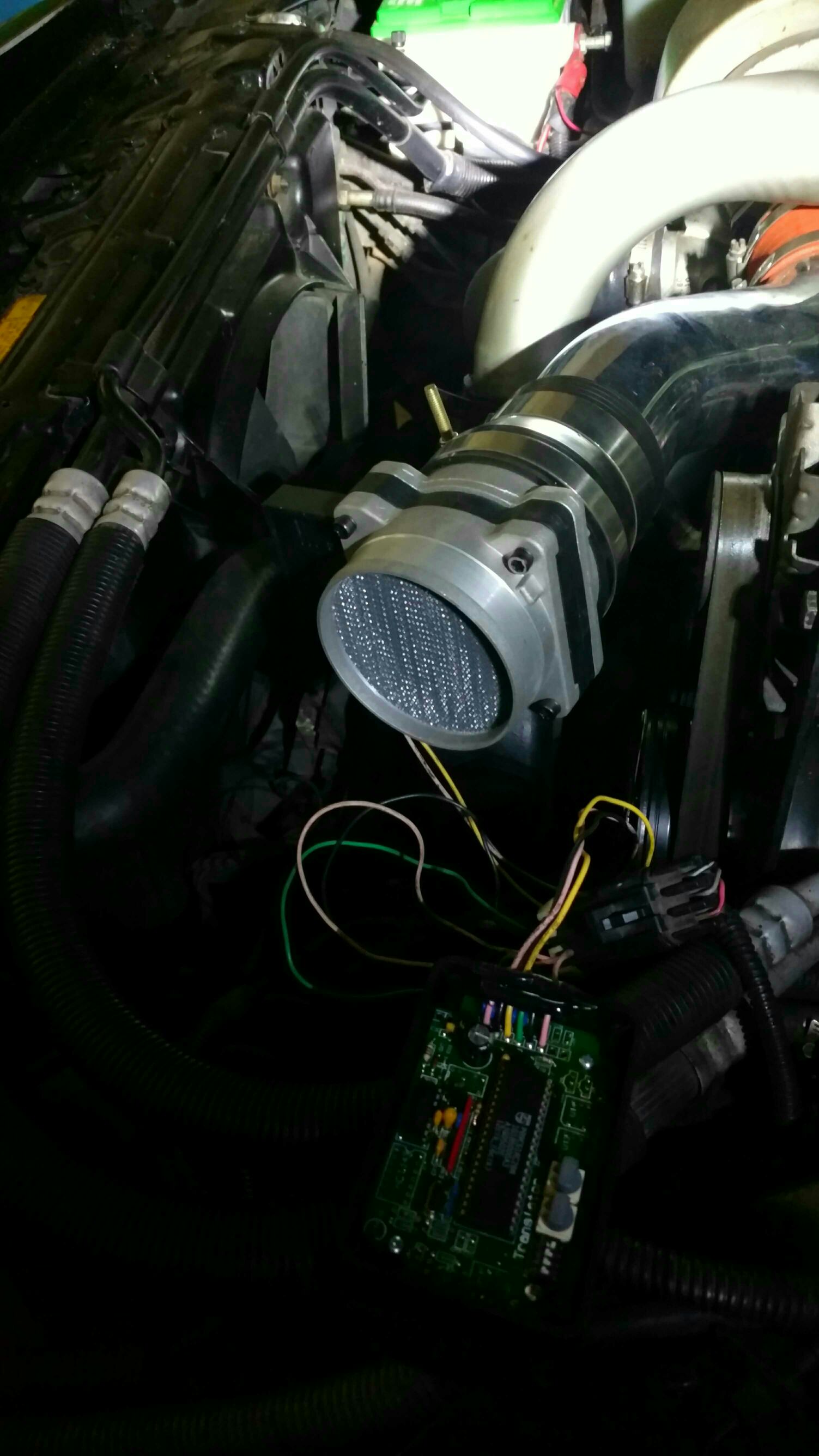

Settings are on,on,on,off and 0 ,0 ..see pics of MAF

Is the harness plugged in so the pink wires line up? IIRC its pretty easy to plug it in the wrong way if you're not paying attention.

That looks likes a non Delco MAF unit. I have no idea if they are as flakly as a parts store stocker.
That MAF looks like one of those Chinese knockoffs you find on e-bay. Get an AC Delco MAF. That is most likely your problem. I have run into this before with wrong calibrated MAFs.
That sucks guess I wasted $100 on this one, Does anyone have a part number for the Delco one?
Good grief! How can you tell from that picture?
