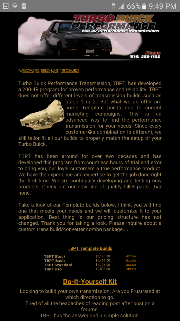

If its the tci that jegs sells stay away from it, mine had a bad 2nd to 3rd flair it didn't last long behind an 11 second car. I recently bought daves tbpt standard and his 3021 converter and by far this is the best trans and converter combo I have ever run.
Give Dave a call. It will be worth your time. Great guy and very knowledgable.
