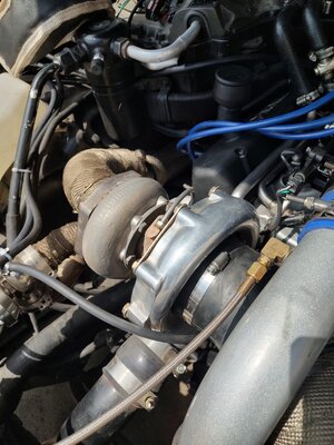

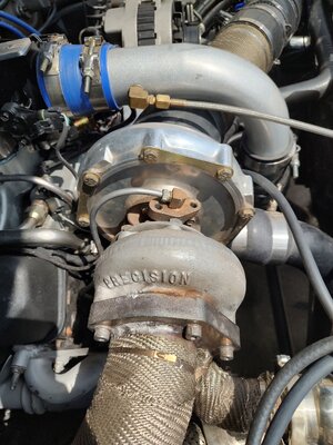

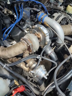

Can anybody id this for me and point me in direction to reseal hot side, it's leaking out of both sides from previous owner putting together. One bolt is cross threaded and not tight, pretty sure I can fix threads for that. Been looking and looking and can't match this turbo up to any I know or have seen with cold big hot smaller. Thanks in advance

You would have to measure the wheels to get the turbo size, its common for the covers to be bigger on the cold side, visually from the outside turbos look similar but that looks big i would guess older pte 6765 4" cover precision .63 housing

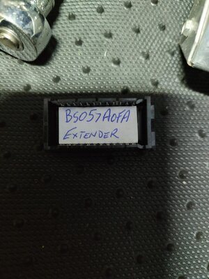

Appears to be an early Extender chip for the Translator +. PM TurboBob aka Bob Bailey the info., he should know exactly what it was designed as since he did the chips and designed the Translator and is always helpful.
From my limited experience with the older stuff.
B early translator?
S stock data stream
0 should be injector size not on my list
5 98 octane alky. chip for the T+
7 100% wastegate d.c. typical for alky. and race chips
A stock cam
0 no anti-theft
F current software revision
A no clue

72mm turbo is way to big , i would look into a modern 62 to 64 mm , it will support way more power then you will need and spool 10x as fast as the 72

I can tell you by looking at your pictures, you have a journal bearing turbo. But we need to find the compressor cover code to be able to ID what it is. If it's a 72mm, that tells me it's probably an old school PT7268 or PT72HPQ. Because all of the 72mm turbos made since the late 2000's have been ball bearing.
Now that we have that figured out, let's move to the hot side and figure out what turbine wheel your turbo has, so we can be 100% positive on what you've got.
Unbolt the 4 bolts on the downpipe and pull it away from the turbine housing. On the flat side of the turbine housing, just above the smaller wastegate discharge hole, you will see another CNC cut part number. On the Buick turbine housings, you will see three letters, followed by one number, then a dash, then two numbers. The code looks like this. THB_-__. If your turbo is a PT7268 or PT72HPQ it should be a .85 A/R and the code will say THB5-68. The 5 means .85 A/R. The 68 means it has the 68mm turbine wheel.
