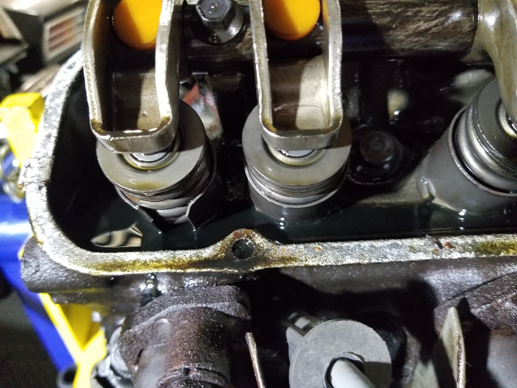

The pan and valve covers are off and nothing looks to be touched in those areas. what failure points should I be looking out for?

Did the stock heads come with "cups" around the valve springs on the turbo setups?

might as well do valve springs since your under the covers.
Springs are in the works, i will look into the 60lb injectors, good to know their not too big for a stock'ish setup and will definitely get a new chip before this is completed.

Unfortunately for my own piece of mind I think I'm gonna be pulling the heads. I hope I'm not going against good advice by doing so. I just gotta know what I have and that it's done right and only once.

Removing the heads just to take a peak isn't the best idea, id wait till its necessary like blowing something or a head porting job, the factory seal is like cement, hard to duplicate the second time without a new engine build.
If you pull the heads you will need to get head bolts. ARP still makes them. You can go with studs but its overkill for your motor. Stock replacement Felpro 1000s work just fine for head gaskets.
