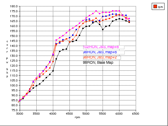

Neel at Apex Speed Technology recently posted this on his blog (Benefits of Individual Cylinder Tuning | Apex Speed Technology)
For detonation limited motors, individual cylinder knock control is a very important tool for maximizing power. On V8 supercharged offshore-powerboat engines, we were able to see over 10% power gains just from having individual cylinder knock control. We’ve seen similar situations on turbocharged Viper V10′s. Its amazing how much 1 or 2 cylinders can hold back the rest of a motor.
The following graph is from Ian Whiteside's Formula 3 engine, tuned with a Motec with a 2° knock margin as determined by headphones on the dyno. The knock controller was then installed, and timing bumped in steps. The engine was run for a season with no damage.
