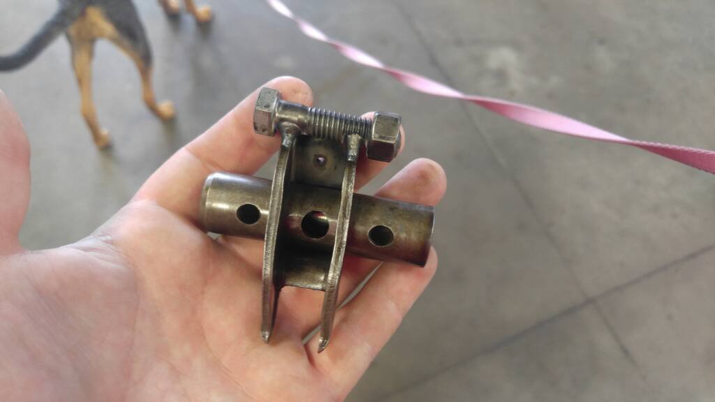

Looking for on the car valve spring compressor.
I can make you one if you still need one let me know
There simple to make cost next to nothing.
There you go go ahead and make one they are pretty easy to make as stated.
Thanks Earl I have that one and it would not work on part of them.
I ended up making one like I saw on the board out of some stock rockers and shaft that I got from Bo McDonald.
And "dank GN" is also sending me one (that may be completed)
At first it was slow going, but as I went along while using it I made adjustments that speed it up to a better pace.
My AFRs went from rock steady 13.0 to 11.5 dancing around and what I can't figure out yet is by changing the push rods and springs only, the main belt (and only)became to short. It was really causing the adjuster to bottom out. Installed a shorter belt.
Rained all day today so hopefully will take it for a drive tomorrow.
Thanks all
Hose clamp on the devil device.
...and don't forget to pop the retainer with a hammer first to crack loose the taper lock.
