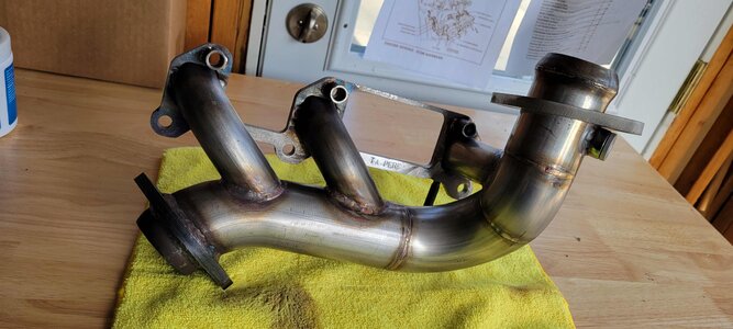

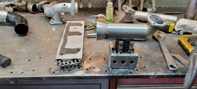

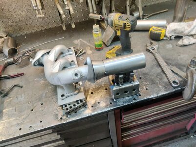

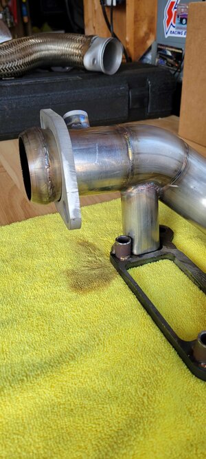

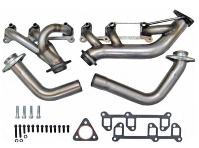

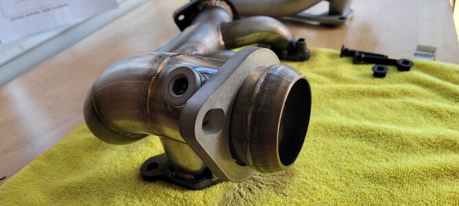

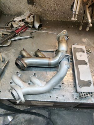

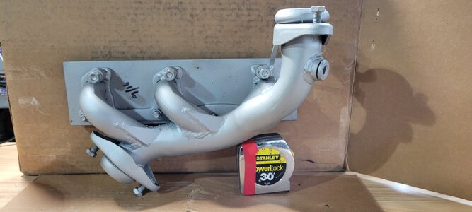

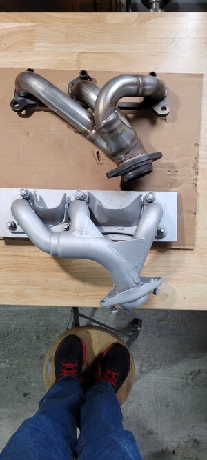

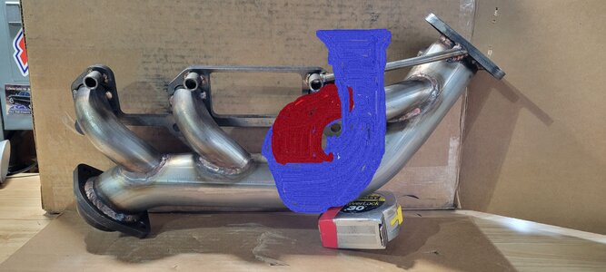

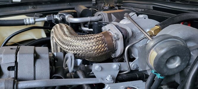

If you can have your shop make the passenger side connector like the drivers side then you should have no issues. i also had to heat my up pipe and do some bending to make the fitment better.
I took the easy way out and got a set of 87 TA Stock Headers manufactured in the good ol' USA and had MotoFab take the passenger side header & my OEM Up-Pipe and he modify it to fit. WHAMM-O a modern SS exhaust headers with the old school look...

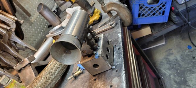

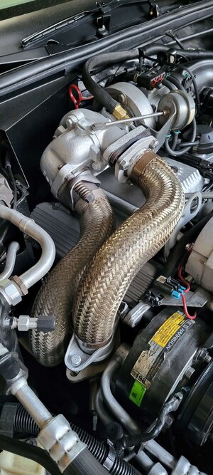

Final product.
