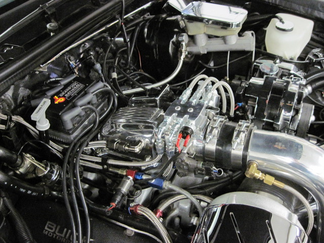

Car has a good size air leak somewhere by the doghouse/throttle body and I can hear it better on the driver's side. I can hear it whistling at idle and it changes with rpm. Disconnected 2 vacuum lines, still had the issue. I gotta start tearing the top off. Either a gasket up top or the hard vacuum lines is broken somewhere. I effin' hate these cars right about now.

Grey racer had the SAME issue and 1 of his doghouse bolts was too short. He put a longer one in it and went back to racing. Also his vaccuum block was cracked at the bottom
Narrowed it down to the PCV/map sensor hard lines. Capped everything off, idled like a champ. Hooked up one line at a time, fuel pressure, boost gauge and a/c/heater vac line, all good, hooked up the two for pcv and map sensor and voila, I can hear the leak and lean condition. Going to replace those this weekend and test again...
A new vacuum block and -3 black braided lines would work nicely.
I have a billet vacuum block, might try to drill n tap the block I have for 1/8 npt fittings for -3an black lines, that will look sort of stock. I'm ditching the pcv and all its issues, going to run a electric vacuum pump and clean up the wire harness etc. Maybe only need a few 4 reference lines- boost gauge, fuel pressure, a/c, and map sensor.
With pcv capped disconnected, got it idling 950 rpms with 14.6-14.8 afr at hot idle in park in the driveway. IAC 28. Hooked pcv with new hose and cleaned out with some carb cleaner, ran well with the a/c on and all new vacuum lines (no metal line for pcv/map) hooked up over to mike's trans shop. blm's at 55mph a/c on and stop light traffic 128-132. Got new set of shane's plug wires as well.
