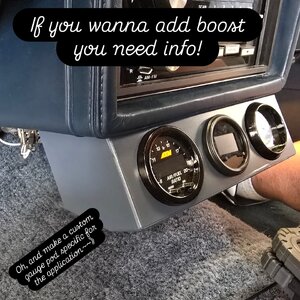

It infuriates me how poorly these gauge pods fit against the pillar, but I think I found one that fits better than the others in a very unlikely place. gaugepods.com
Light trimming
Lots of JB weld and clamps
End result is okay I guess
It hugs the pillar a lot closer than the last one did, and I was able to tuck the wires a little better so that the pillar trim would actually sit flush. I have no idea how people get 3 gauges to fit on the pillar with all that wiring! I'm still not super happy with how this turned out, but it will have to do.
Light trimming

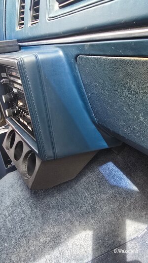

Yeah they are ugly. That's why I went digital dash, It is still a bit ugly but I'm working on a solution to that. Also If you have a bench I have these for sale.
