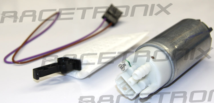

New siemens hp fuel pumps 300lph
I wish I had a better understanding of flow data, because I'm sure it would help me to decide which pump would be best for my combo...I kinda ruled out the new Walbro because it won't be available till the end of the year..
I'd like to know more about this new Siemens pump & if it can supply the amount of fuel I would need for my combo running 25 lbs of boost & spraying alchy via single nozzle or would the new DW pump be the best choice?

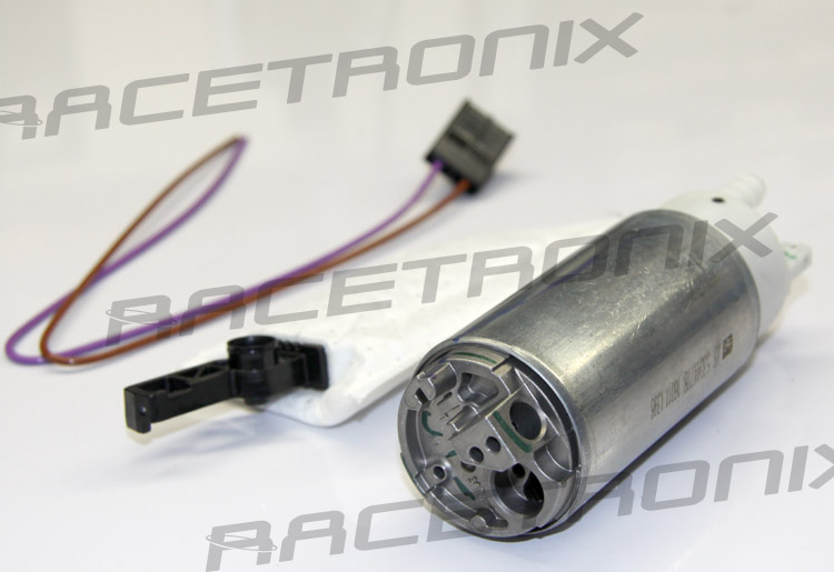

According to the flow data on the website, at 70 psi (which is 45 base plus 25 boost) this pump will supply 61.5 gph. This is enough to support 60 # injectors at 100% dc or 70 #'s at 85% dc.
Unlike most Walbro HP pumps, this is an OEM pump intended for a specific current application. It is a quality pump built in North America by Siemens. All pumps are thoroughly tested at the factory to meet OE spec.
Since this pump is not going to be used in its original application and there is no control over the application, operating environment or installer qualifications it is very difficult to offer warranty at this price point.
Racetronix may consider offering an in-house warranty as an option to customers who feel they need that extra piece of mind. Right now we do not feel it is required.
You may have to make some alterations to the mounting area. It would be similar to installing a Walbro pump with an 11mm offset inlet which is typically used on imports.
I got it! Thanks Jack! The wiring is opposite polarity and I did have to trim the base of the pump to fit in the hanger, which took all of 2 seconds. I like it so far. Its quiter than the Walbro too.
