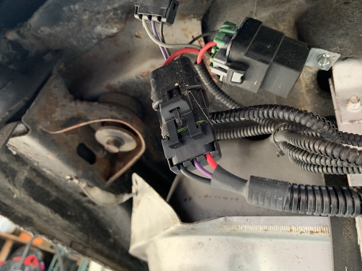

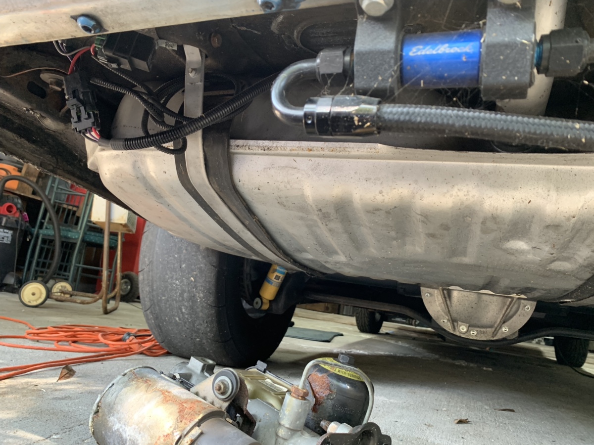

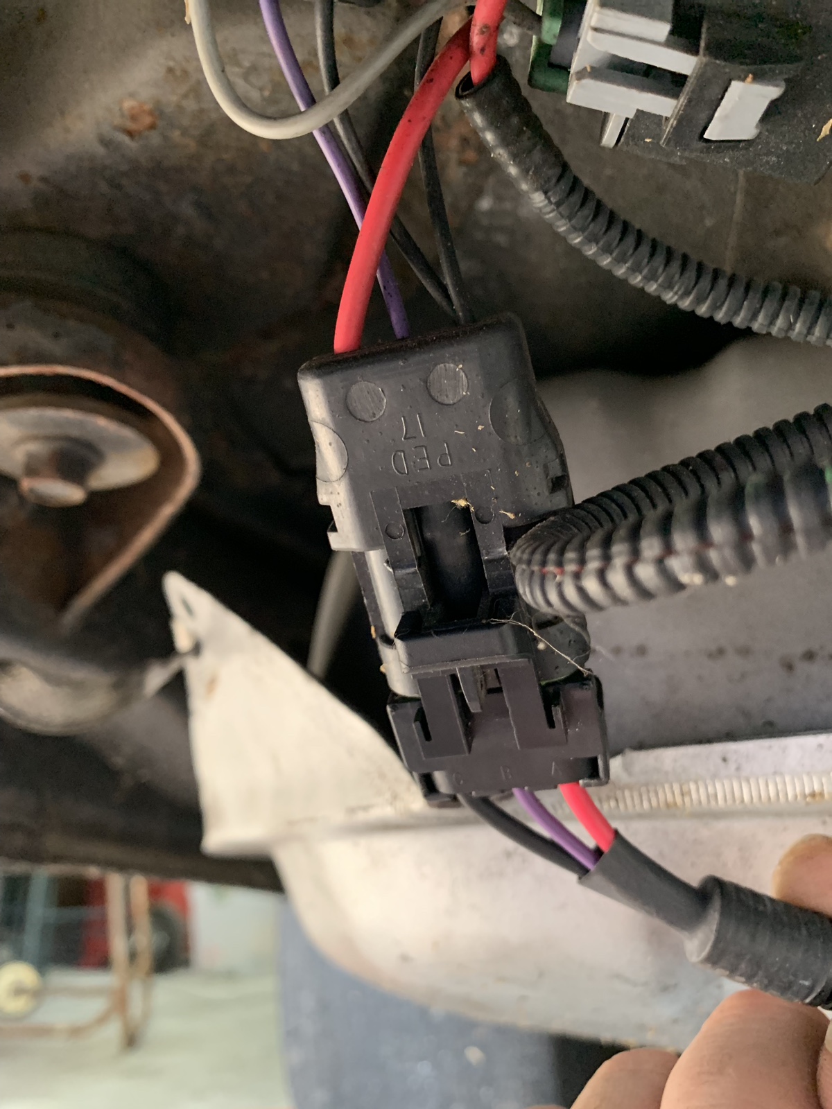

We got it guys!!! This was a combo problem! The harness from racetronix was incorrect to the Hotwire kit! Also, we ran ground direct to battery! Fired right up.. here is pics of the wiring as it was sent.
If you want to tidy up that harness, I believe the relay bracket will fit right over one of the bumper mounting bolts. Then the hanger harness will go over the tank strap. It will not be seen from rear that way. Of course that fuel filter is mounted under the bumper which is odd. I would relocate that also.
Good job , way to stay after it !!
Thanks for posting the fix .
