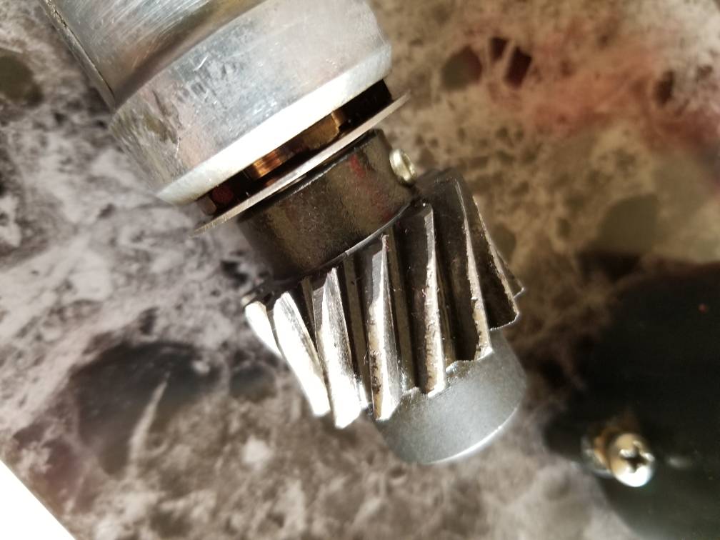

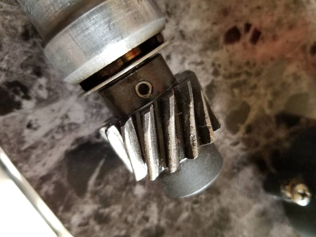

Everything seemed to work how it should .... but when I pulled the sensor out I found out it was beaten half to death in it former life!! And the gears were worn pretty bad. I took to john at caspers and he told me not to put it back in! I checked the cam gear it still looks new. Thank God since it is a new rebuilt engine!!!!

Its stock John asked me the same thing .... he thinks someone ran the sensor without it being inserted all the way in its hole .....?

No roller stock rebuild and no oil mods ..... at least I dont think.
I still dont know why the car all of a sudden didn't start. Will worn gears cause the cam sensor to go out of adjustment? If not I need to take a closer look at my crank sensor.....
No, the worn gear would not prevent the car from starting.
