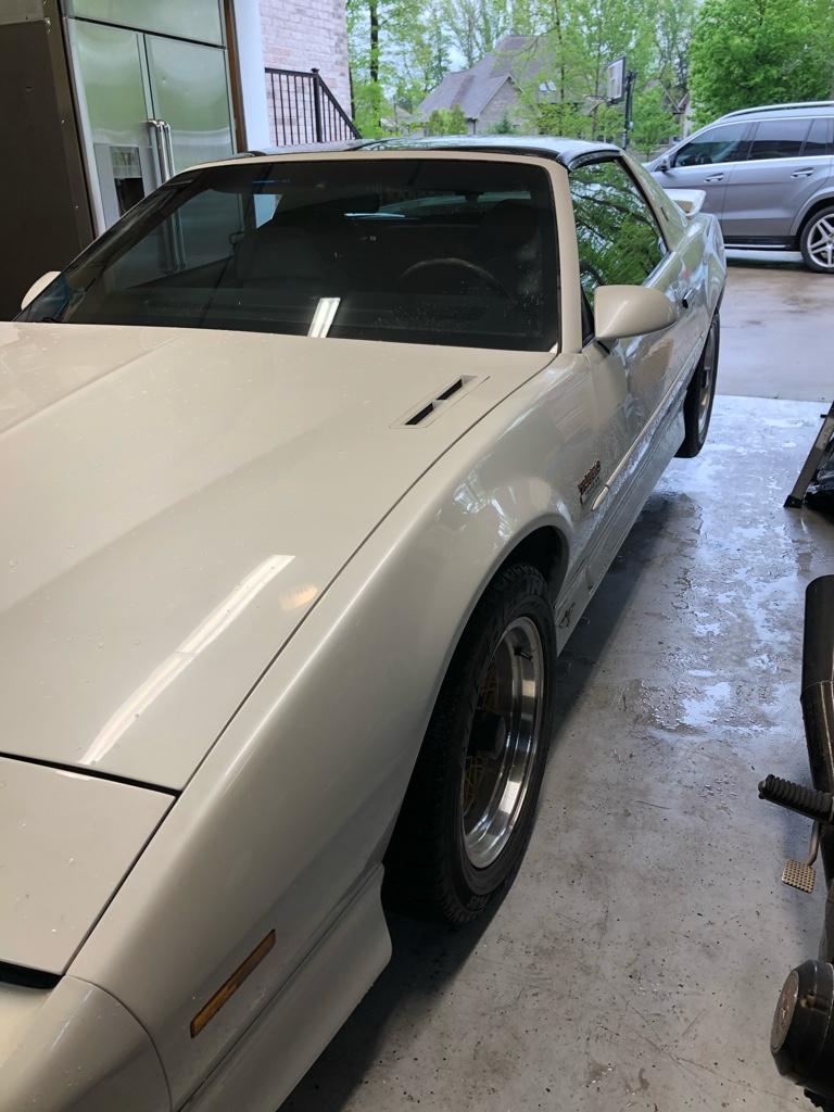

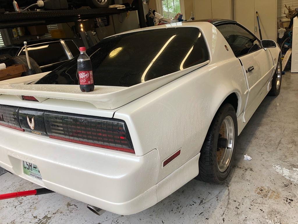

ill post some pics of it......
its painted lexus pearl white. has koni reds on the front, bilsteins in the rear, new tires albeit from 9 years ago, car has 80k on it, and byt he records has had about 4,000 miles on it in the last 15 years.

pics to come.

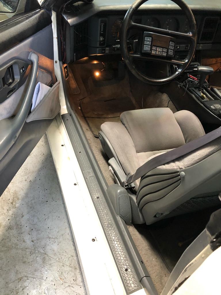

I can’t figure out if it was stolen or not. ‘Story’ is the original owner didn’t like the interior and replaced it. I find that hard to believe. I’ve gone back a few owner’s so far to ask questions.
Yup, I’ve heard this story multiple times on the TTA forums. Owner supposedly had the dealership swap out the beechwood interior to grey. Great pickup!
