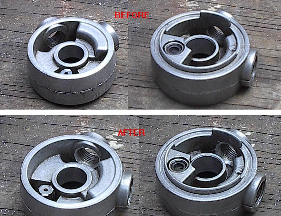

the threaded holes on the oil cooler sammich adapter are 1/2NPT. You can convert to AN fittings for fancy schmacy braided lines, like this....
Or just get some 12/NPT to barbed brass fittings and use hoses and clamps.
Whichever you do, tape off the bypass valve and port the inlet and outlet of the sammich adapter.
In this picture it doesn't look like much was changed but it real life it looks much better.

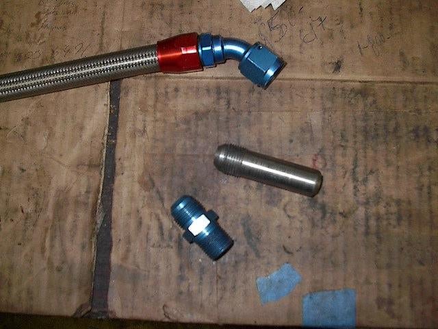

Does anyone sell these fancy schmacy braided lines pre made for direct replacement?
You have to build them yourself. There's no way to sell fancy schmancy steel braided lines if you don't know what oil cooler is used, where it's mounted, or what size lines you need.
They're really easy to build if that's the way you want to go.
This is the one I bought awhile ago with -10 lines and fittings . One day I'll plum it in
