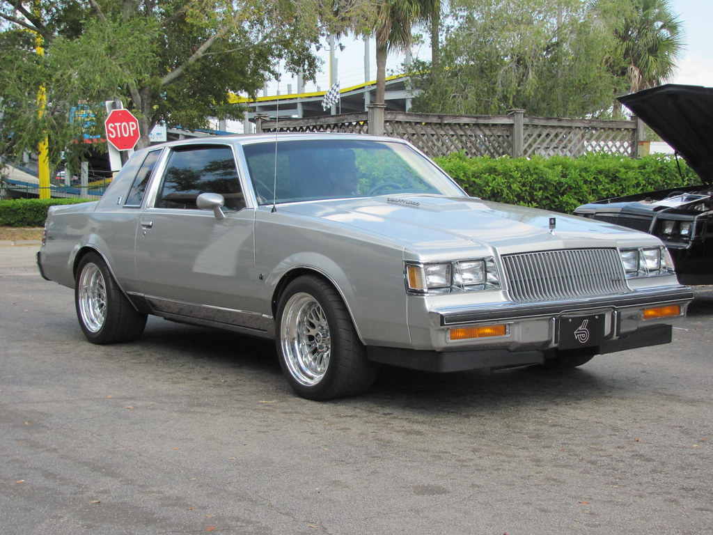

Here is a pic of his car that I took a few months back in Orlando:
That is a pic of Mario65's car. I believe he runs 17x10 on all four corners. 4.75 backspace. No frame mods that I recall. The wheel/tire sizes are in is sig, several posts above this one.
When I saw his car in person, I remember that the front tires are closer to the edge of the fender compared to the rears. That's probably why he recommends going with a 9 inch on the front rather than a 10.
