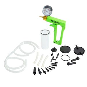

Pick up a brake bleeder kit. They're cheap.
It will come in handy for tracing vacuum leaks later. ;)
