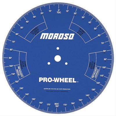

The larger diameter the wheel, the more accurate it could be. I just use a coat hanger as a pointer. Just don't bump and bend it or you get to start over. Make good notes and yours will be RIGHT.
For those with unlimited budget
https://www.ebay.com/itm/Summit-Rac...:nToAAOSwumJdOGr7:sc:USPSPriority!76017!US!-1
More my price range.
what I have but didn't pay near that much for it.
