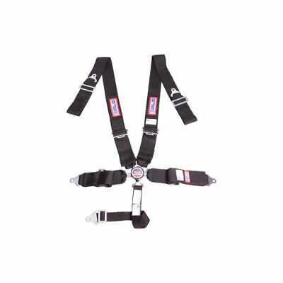

Which brand did you go with that will recertify?
I went with RJS . Mine is silver / grey . It comes with bolt on or wrap around set ups .
