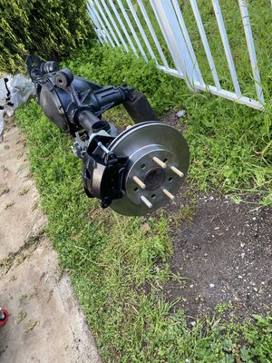

Rear disc brakes
Where are they hitting?
They look very similar to mine except the E Brake
Post some pics
I'm going to change to a GM Proportioning Valve 4 Wheel Disc Brakes from Summit racing
Post some pics
I attached some pics, The rim is hitting the caliper where it is welded. I’m going to try a small spacer and see if that fixes the issue.
Hope the sparer works it should
Those look like they have to E Brake too
Summit part number SUM-760185
In the reviews someone used it on a GN and said it worked great stopped the car much better
