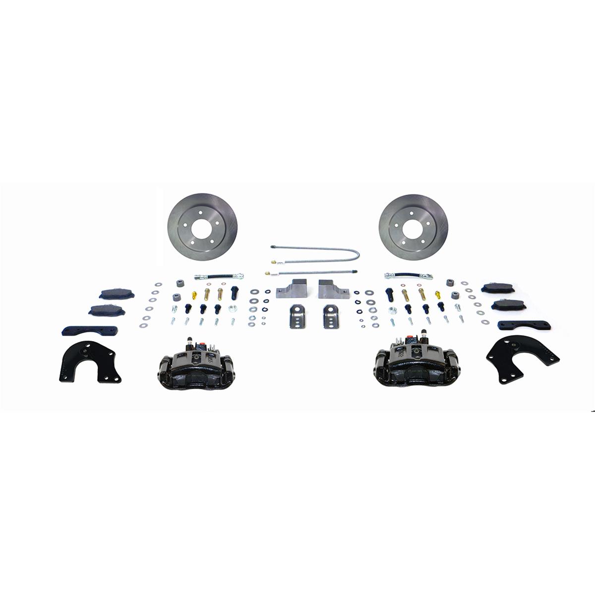

I put the Right stuff kit AFXRD78Z from summit racing back in 2020 They were a lot cheaper than today.
Installed new axles and bearings at the same time and new proportioning valve for Disc rear brakes.
Zero issues with this setup.
pictures are on the 2020 thread Rear Disc Brakes.
I decided to add my experience with the SSBC rear disc conversion kit I installed in 1991.
It’s not cost effective so I didn’t comment earlier.
At the time I was concerned with returning to the factory 15” GN wheels and bought this kit.
Pros:
It will fit with the stock 15” GN wheels.
(The stock 15” GN wheels are reverse mount and have the smaller dia. on the inside of the wheel where as the T-type wheels are front mount and have more room on the backside).
The calipers (‘87- ‘93 mustang/ cougar with E-brake) clear the wheels by 1/8” except where the weld on the wheels overlap, clears by only 1/16”.
No modifications to axle flanges or housing are required.
Can be installed without removing axles if you cut the old backing plate off.
Cons:
Must retain stock ride height so the caliper don’t hit the frame. They still hit with two adults in the back seat.
Replacement rotors are only available from SSBC. (‘86 corvette front rotors are turned down to 11”. The backside of the hat is machined larger to fit flat on the axle flange.
They didn’t come with longer E-brake cables or brackets to hold the stock E-brake cables. I think the stock E-brake cables could be loosened and brackets added to work.
They won’t work with C-clip eliminators as they mount to the outside of the backing plate flange.
Overview:
Overall the assembly was easy and straightforward.
I was impatient and didn’t take the time to get the E-brakes working.
The directions didn’t say anything about changing the proportioning valve to disc/disc. I didn’t know any better so it stayed.
My car had less than 30k miles at the time. I assume the C-clips were fairly tight as I didn’t notice any brake pad knock back, but that was probably due to retaining the disc/ drum proportioning valve.
There was no improvement in braking power, but they looked real cool and I had “rear disc brakes”!! lol.
I have since changed to a generic 11.63” (‘96 Camaro rotor) and ‘77- ‘82 Eldorado/ Seville caliper kit from Speedway Motors that mounts to the inside of the backing plate flange to work with C-clip eliminators.
I had to make new caliper brackets to rotate them down away from the frame for clearance.
It doesn’t come with E-brake cables, SS braided caliper hoses or rotor options, but is cost effective if you don’t mind making new brackets and running at least 16” wheels.
