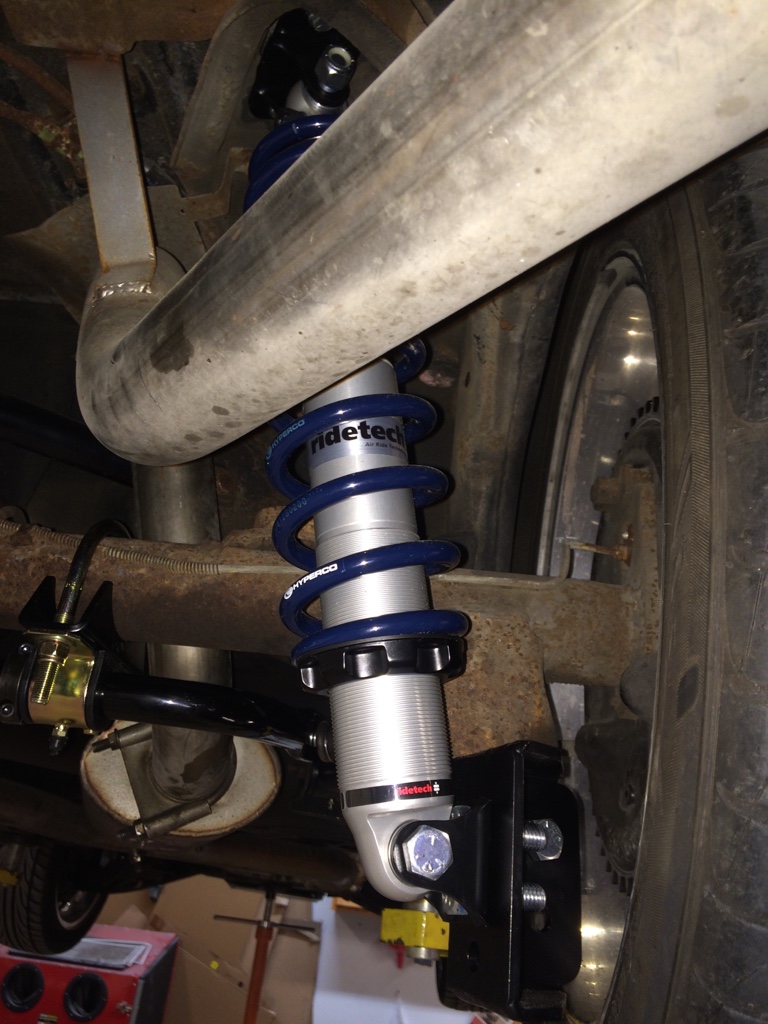

Ridetech thought they should fit. We sent them pictures of the shocks trying to mount to the brackets. ridetech clearly saw that the bracket wasn't correct. Said they would design a new bracket. Said they never did an air ride with a moser 9". Appreciate the pic. Thanks.
Is that a adjustable rear lower bracket from Ridetech? Also my pass rear coil is turned higher than the driver coil. And yes they are the best ride I've had, coming from drop spindles, DSE, amd Hotchkis.
your brakes arent going to work very well with the swaybar u-bolt crushing the brake line . u-bolt should have been slid under the brake line
Yes, the bracket is from Ridetech.
Thanks for the heads up. I'm going to take another look at the sway bar setup.
