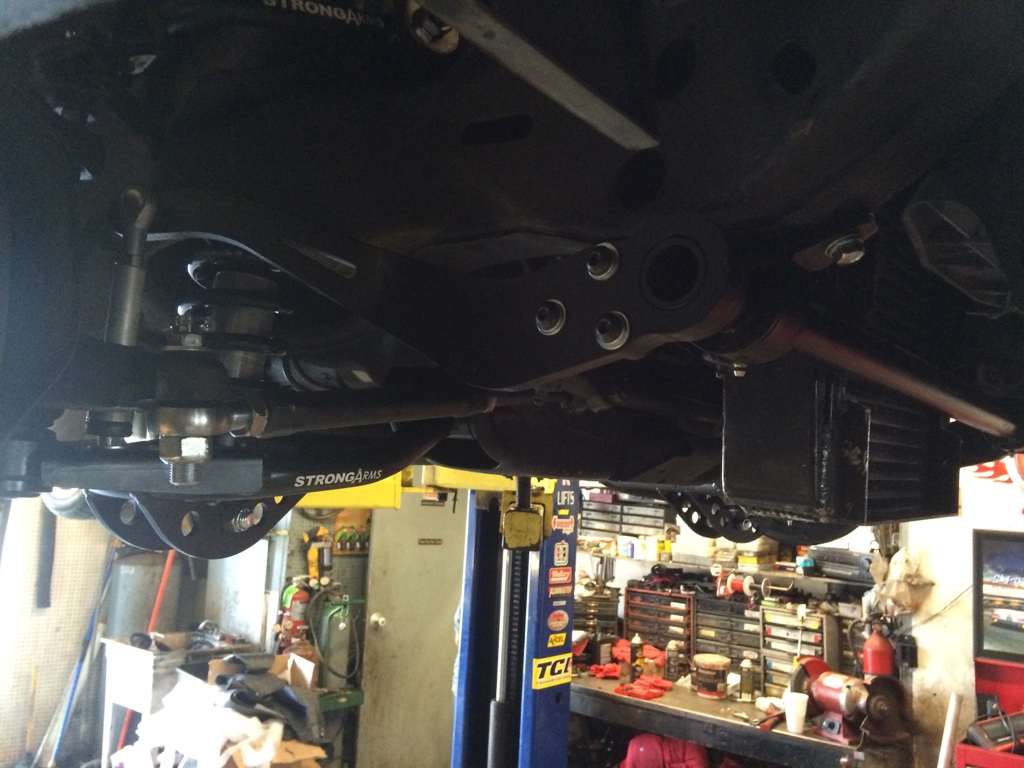

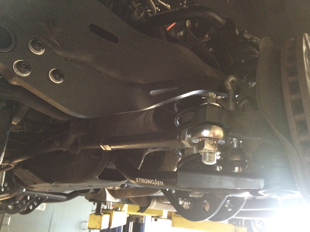

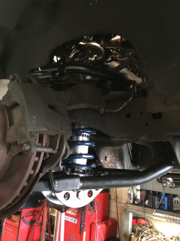

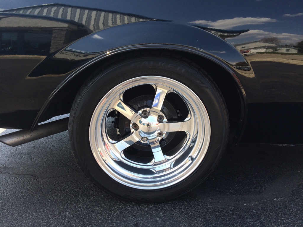

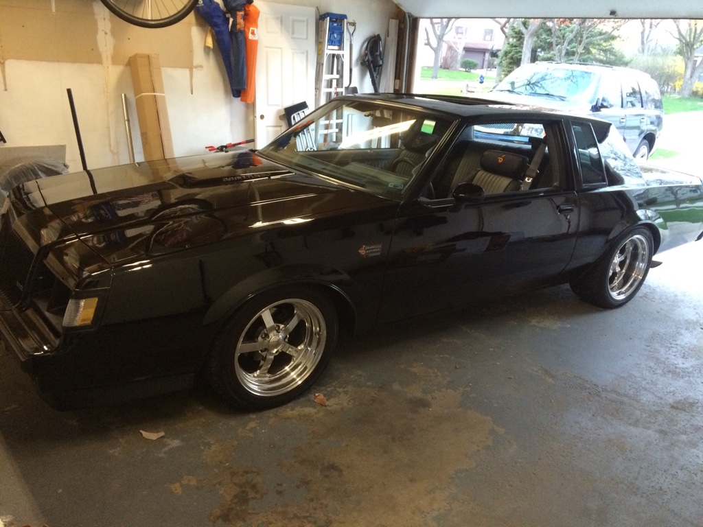

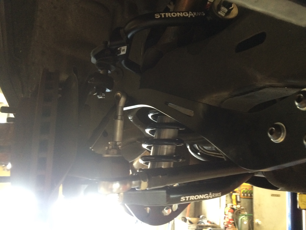

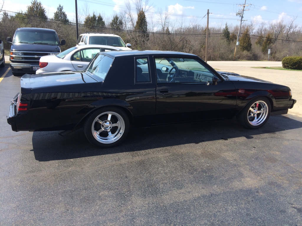

Ridetech single adjustable coilovers front and rear. Upper and lower control arms front and rear. Ridetech front sway bar and Detroit Speed rear sway bar. I had reputable mechanic install the front parts and a buddy and I installed the rear. Car is aligned and ready to go. Overall the installation was very straight forward with no real surprises. Some small issues: Couple of the old bolts were near possible to get off, having the car on a lift helped a lot. Had to make the notches in the SLIC a little bigger to accommodate the front sway bar.

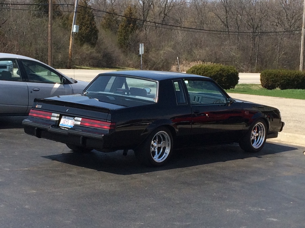

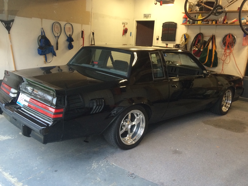

First impressions are very positive. Car is a lot tighter now, it drove like a big boat before. I got on it once and it went a lot straighter than before. Then the adjustable wastegate came off so that put an end to my testing for the day. Here are pics without any real adjustments done to the height.
