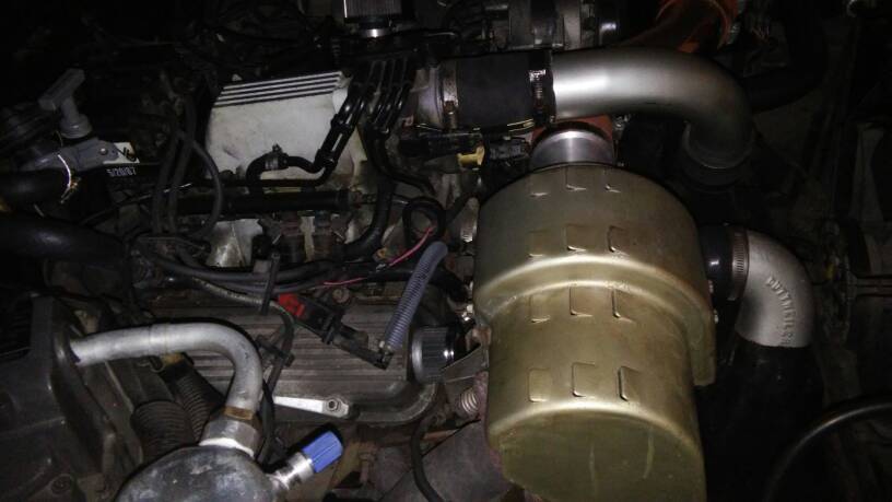

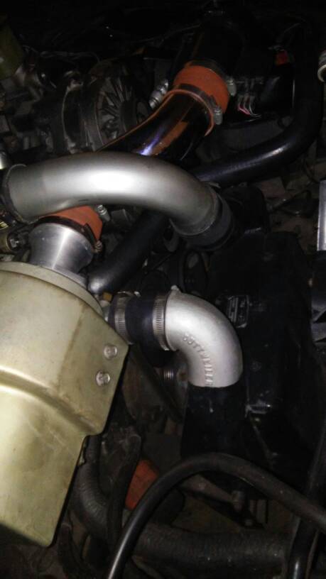

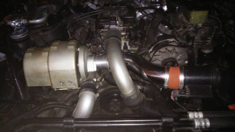

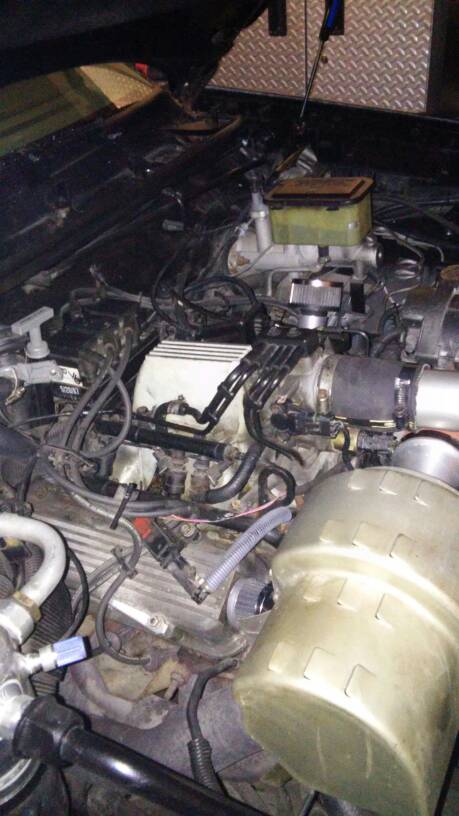

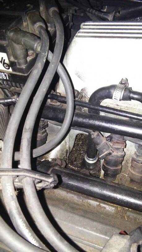

Hopefully pictures are worth thousand words, looks like oil on top of intake, do you think its coming from pcv?

couple things.
those MAF sensors with the connector pointed horizontally are known to be "not great", you might want to try to borrow a known good stock one to test with.
the plug wires have a green tinge to the coil end boots, so they probably need replacement. at least pop them off the coil towers and clean up whatever you see (most likely a lot of crud)
make sure your wastegate hoses are good, then ends tend to dry out and split, causing overboost and broken parts
those injectors look original, you may have a sticky one, check for worn spots on the injector wiring harness also.
I wouldn't worry about a little oil on the intake, they all seem to get that way.
