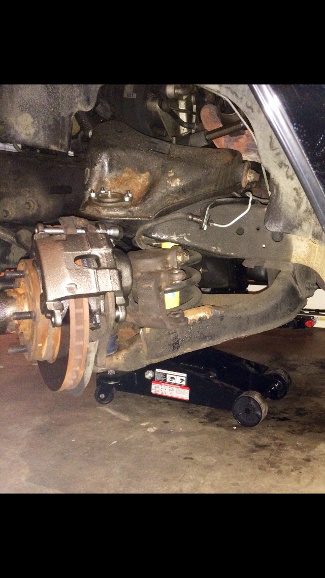

Hey guys. Getting ready to install a pair Russell hoses on the front brakes. I'm wondering if it's as straightforward as it looks or if I should be wary of anything? Line wrench on the hose side and another on the hard line?

Super simple, as long as your fittings aren't overly tight, rusted, or already rounded off.
Very smart mod in my opinion. Helped my brakes that's for sure. Firmer pedal because the old mushy lines weren't expanding every time I hit the brakes after the swap.
Wrenching off one of the fittings is almost a given on these cars. Lube it down before disassembly
Maybe I'll get lucky. Figured I'd replace these, along with my sticky calipers.
Just installed some today, yes they have a clear coating/tubing over the braiding. Did the front two and the one in the rear. Fronts were very easy and the rear was a PITA. Replaced calipers too.
Get some jack stands under there before commencing work.

Alright, finished this up the other night. The install was easier than anticipated, especially since I was replacing the calipers at the same time. Break loose the hardline, pop off the retaining clip, then continue to separate the hardline from the caliper hose. Then just reverse the process.
