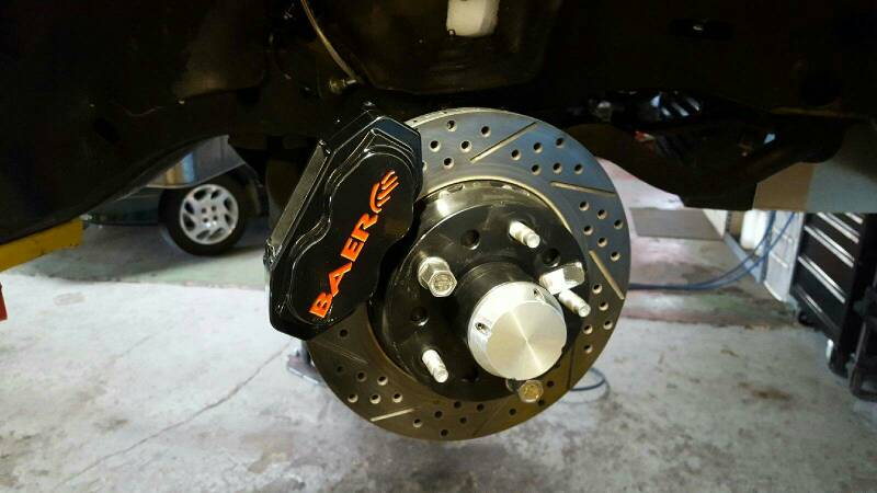

I run baer brakes front and rear on my car. Got both sets from nick at www.arizonagn.com as he's right down the street from baer and his price is better then listed. I love kirbans don't get me wrong.
Also have them on our low milage car

So waiting for my trans to show up so thought I would do the brakes, front suspension, and steering. Anything I'm missing I should just replace while I'm at it? Or any other area in the front I should do while the motor and trans in out.
brakes
front baer brake kit
rear dics con
all SS brake lines and SS brake hose to the calipers
