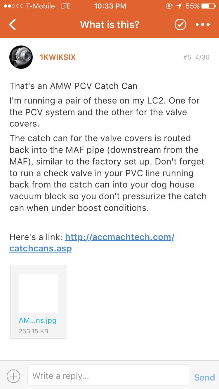

here's one of the posts I came across mentioning routing back into the MAF pipe.
As mentioned thats how theyre set up stock, the reason people run open breathers is so the turbo isnt sucking up hot oily goo- which would be greatly reduced by the catch can. I have a catch can on my pcv as well and im always surprised how much stuff it catches. As for the smell, i thought id be fine with it but on a hot summer day in traffic with the windows open when the fan comes on it gets pretty unpleasant. Try just the simple can(s) with breathers, you can always remove the breathers and pipe the cans back into the intake if you wanna change it up. Also, the cans will probably be more effective with some vacuum drawing the vapor from the motor vs just pushing out to atmosphere.
