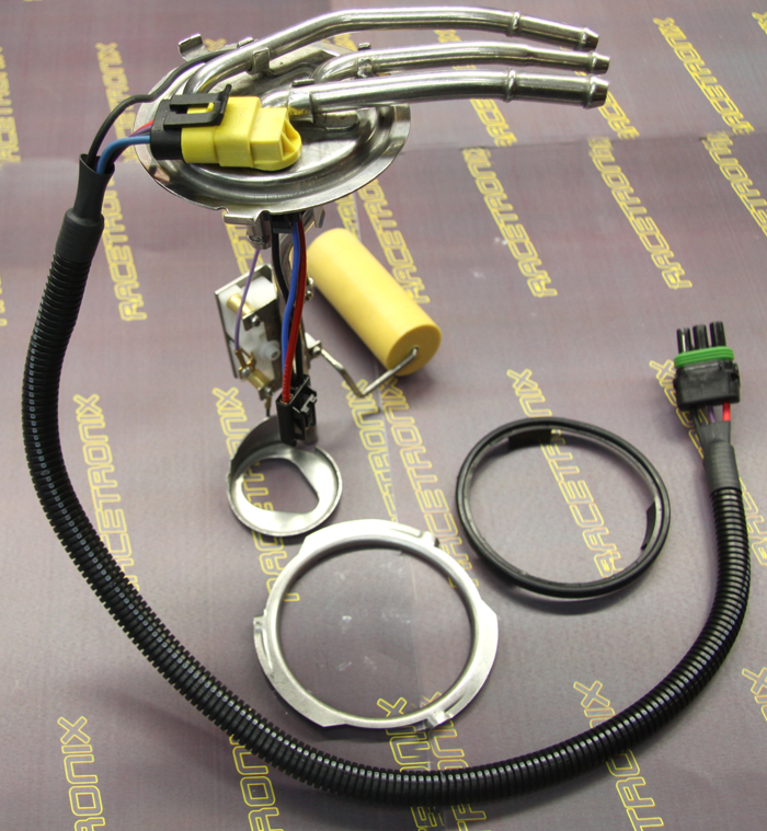

John do you have both sides of that connection ? Because he will need a new bulk head connector (yellow through tank connection). I had one go bad on my car and on my '92 GMC pick up. I got one from Racetronix for my car.

I had the same thing happen to me last summer. I changed the walbro pump out to a detchwerks pump melted the plastic then insulated the pins..
I could have avoided it all together by changing the in tank harness when I had the tank down to change the pump...
I haven't had an issue with the racetronix harness drove with it all summer no problems....
when you say racetronic harness,are u talking about the intake harness,im looking at maybe buing a racetronix sending unit,do they come with a new intake harness,i assume they do
There wasn't any issues with my sender so changing just the in tank harness worked for me..
I suppose either will work for you if your sender is still working.

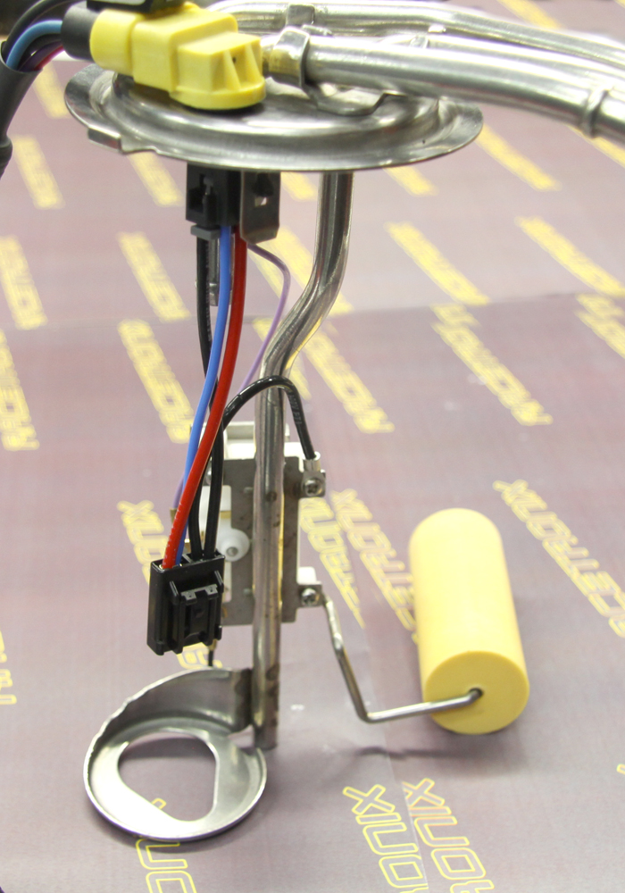

If you do change just the harness securing the bulkhead connector to the sender is easy to do with a deep socket ( I think 1/2" or 9/16" forget the size)
Yea, I have both sides. It ohm'd out nice. He'll need to use his old retainer though. Maybe the o-ring too, mine is a little old.
