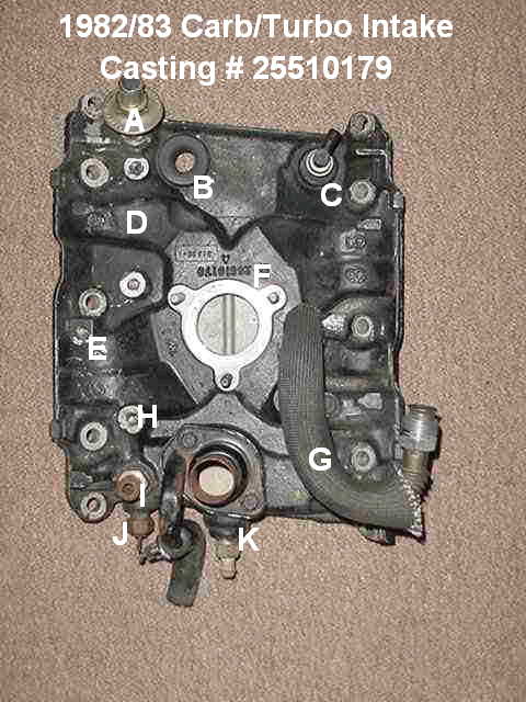

The 1" hole that you plugged sounds exactly correct for an '82 plenum. This would be where the EGR flex pipe would bolt into.
You can see the pipe in this picture (labeled G):
The EGR valve in the picture looks correct. You need it or a block off plate in place where it bolts to the backside of the plenum.
