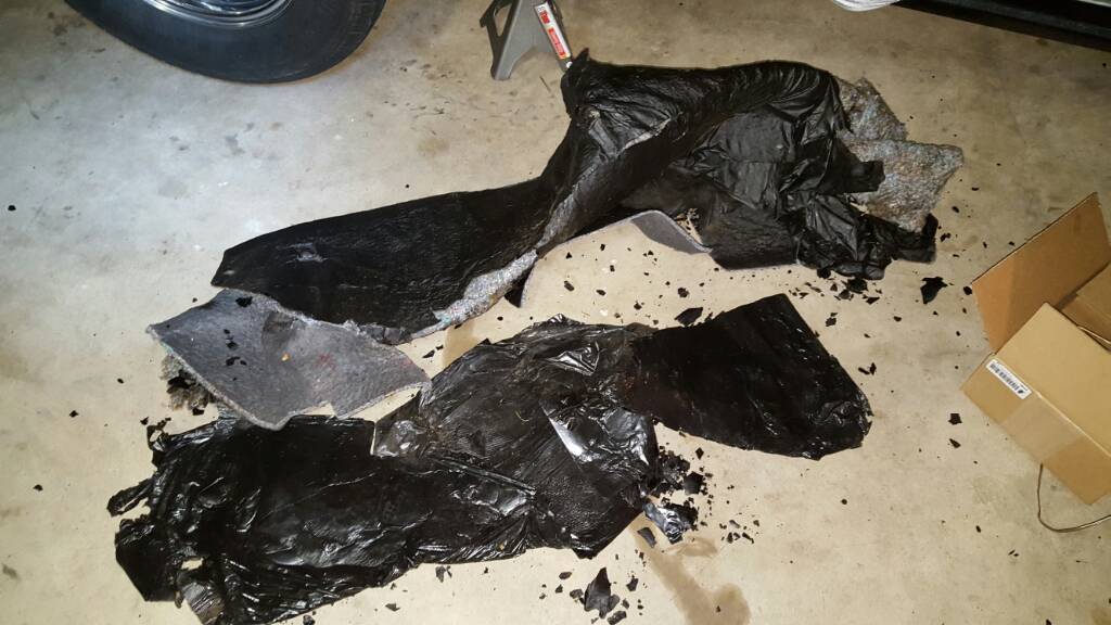

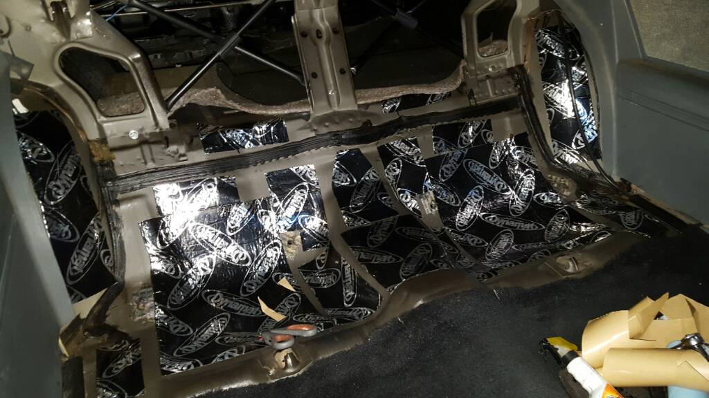

I used dynamat extreme under the rear seat. The black tar stuff broke into hundreds of pieces when I pulled out the original insulation. I removed the remaining pieces off the insulation and reinstalled in the car. The car is much quieter.
