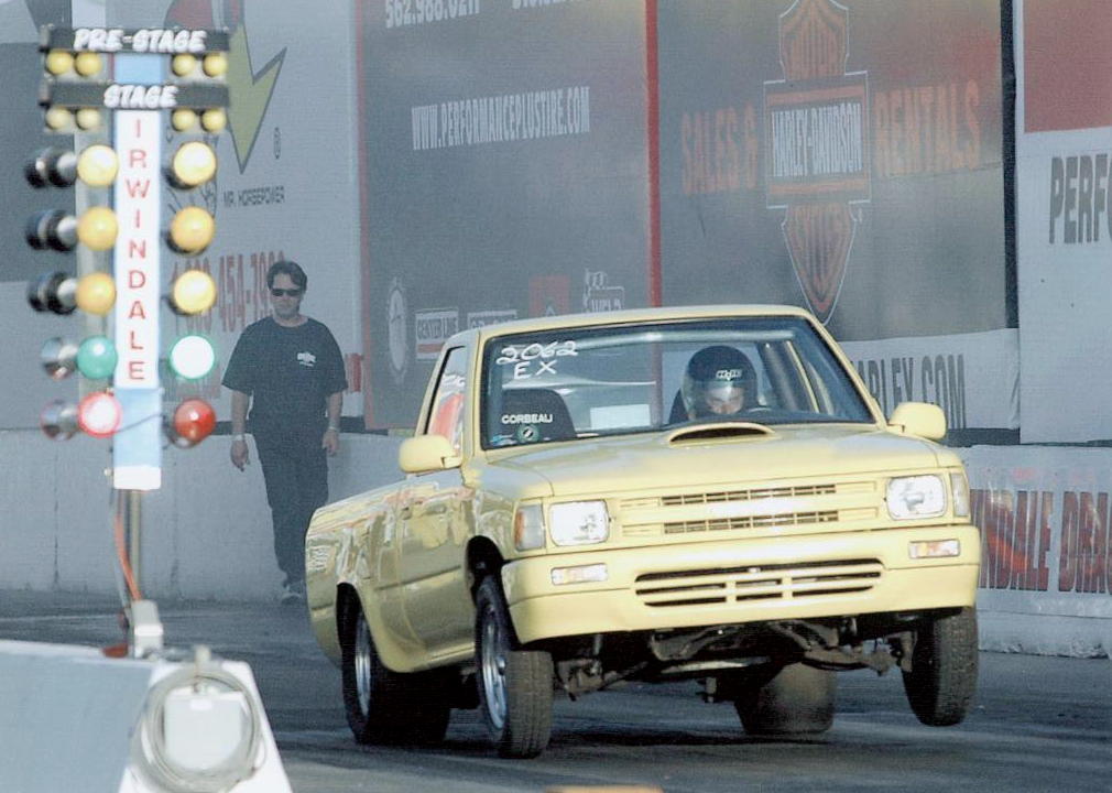

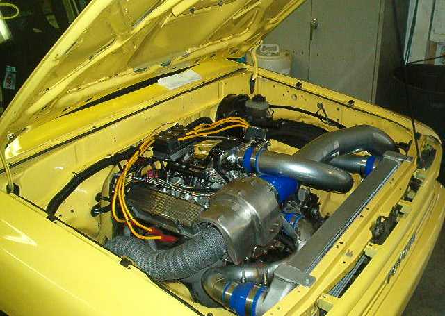

Originally posted by Chevota
Ok,ok....I admit, I did have the valve covers off once to change the springs;) So, anyone think a 76 is too big?:D
here's a couple of pics
http://www.dragtruk.com/PICS/LG8LJN5MQ8YL2.jpg
http://www.dragtruk.com/PICS/LG8LJN5MQ8YL4.jpg
-scott wile
Too big? I think it's too small! Get that PT88;)
Nah in all seriousness I think you should try the TSM turbo (70 GTQ) and if you can't get it to go any faster with that turbo you'll know it's time for some ported heads (with a port matched intake) and maybe a cam:)
